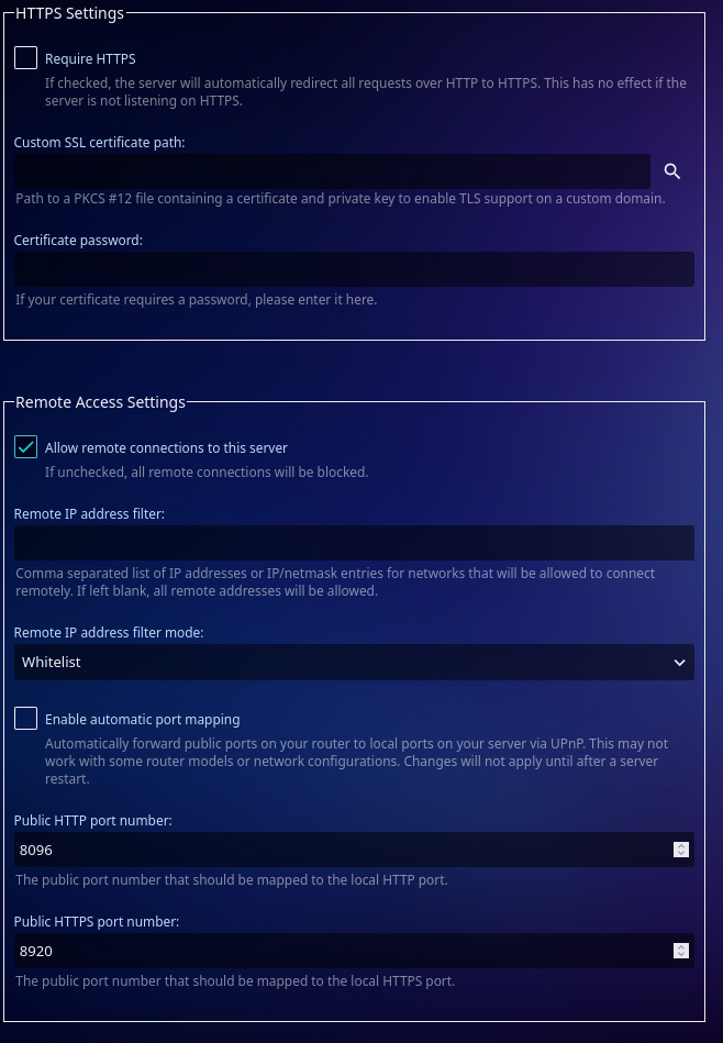

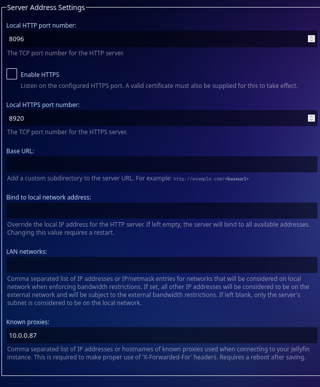

    My jellyfin Autodiscovery service is acting up a little, the server is being discoverd but it always points to 127.0.0.1 instead of the actual server ip. My jellyfin (Version: 10.8.12) runs in a docker container, that my be a hint but I cant really figure out the real problem. As a matter of fact, can I somehow configure the uri that is used for autodiscovery? I have attached my networking config in the Dashboard. Thanks for the help!

    In your last screenshot, there's a box to define what autodiscovery reports as (Published server URIs). Although the more common way to do this in a docker container is with the environment variable 'JELLYFIN_PublishedServerUrl'

    (2023-11-20, 07:57 PM)mcarlton00 Wrote: In your last screenshot, there's a box to define what autodiscovery reports as (Published server URIs).  Although the more common way to do this in a docker container is with the environment variable 'JELLYFIN_PublishedServerUrl'
    Ok thanks for the tip, but I cant seem to get that working, I tried the proper uri i.e. http://<ip>:<port> I tried just the ip and I also tried the domain of  my reverse proxy and always get this error in the logs "Jellyfin.Networking.Manager.NetworkManager: Unable to parse bind override"

    just add it as an ENV to your docker
    JELLYFIN_PublishedServerUrl=http://jfserver:8096
    i can report it works perfect from there but i have never tried from the Server URI Override in the jellyfin dashboard
