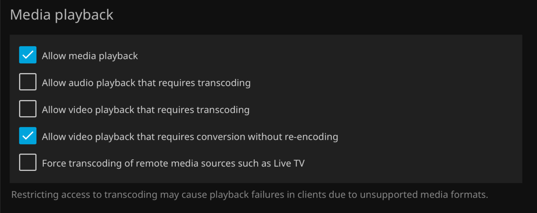

    I made some more tests and as it seems, I can disable all transcoding settings, but not the remux option:

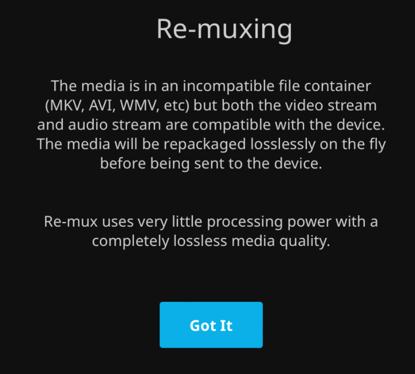

    The Dashboard explains why, see the attached screenshots.
    Even as the video is H264 and the audio is AAC, which can both be DirectPlayed (with the Jellyfin App on iPadOS) the container is MKV - and this seems to be the problem and the reason why numerous files get created in the ../transcodes folder.
    I did not read that from the JF Codec pages, and thought that only H265 codec does not work within MKV containers.
    That is a big problem for me.
    Tomorrow I may just try and create an MP4 or MPV(?) container and repeat the test.
    I need my content to work without any transcoding, but I need my language, the original language and any commentary - also all subtitles for those languages. And from what I remember, only MKV allows this.

    For this, I created both H264 and H265 videos in a MKV container - and the Dashboard in both cases says that the video is played "Direct".
    Also, in both cases, the video get's remuxed - because of the container!
    I repeated the same with videos without any audio and then even without any subtitles, just to be sure - same behaviour!
    And, I see new 76 files to be created in the transcodes cache, directly after starting the video - together they have the same size as my test file!
    That means, that watching any video will rewrite the same amount of data to disk - every time I watch a video! This is not how it should work.
    I need to get rid of this.

    2025-01-14, 06:13 PM (This post was last modified: 2025-01-14, 06:16 PM by jellyfin. Edited 2 times in total.)
    I can confirm that there is a problem with the MKV container!
    As soon as I use MP4, the files get played directly and also without remuxing - and YES, there are NO files in the "transcodes" cache anymore!
    If this is NOT the expected behaviour (which I assume), then this is bug - either in Jellyfin server or client.
    OR, in what both makemkv and Handbrake produce in MKV containers.

    2025-01-14, 06:33 PM
    That's expected behavior. MKVs are not widely supported by all clients to begin with. MP4 are, so there's way less of a chance that MP4 containers will cause a remux.
    What Jellyfin is doing is remuxing your MKV container to MP4 so that the client can play it.
    This is not a bug. The client just can't handle MKV containers most likely.
    In order to remux, Jellyfin needs to store the final result in the transcode directory where it's then sent to the client for playback.
    Just to clarify, remuxing is not the same as transcoding. Remuxing when a client reports it is not compatible with the container is the expected behavior and remuxing uses *very few* cycles (i.e., small amount of CPU or GPU). Transcode/remux files in cache are temporary and cleared out on whatever schedule is set in your Scheduled Tasks. I would not fret about this, very much the expected behavior.
