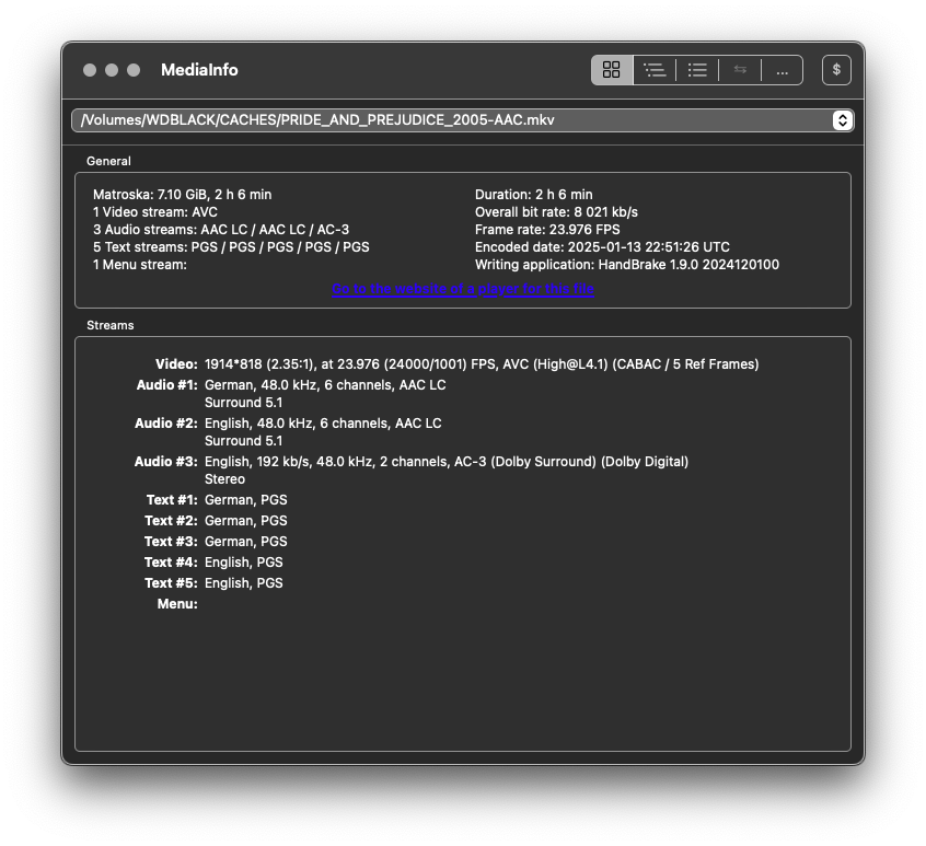

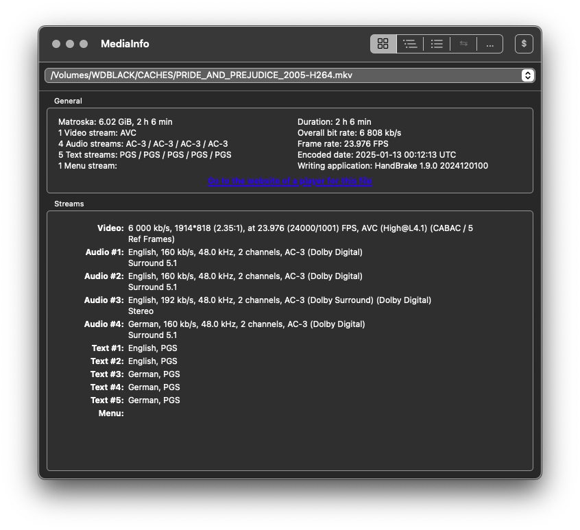

    (2025-01-14, 12:23 AM)bitmap Wrote: Can you do a mediainfo or ffprobe on the example media file? You may be able to fix this one issue with a single ffmpeg or mkvmerge remux. It's weird that the incompatible container is the issue.
    I installed MediaInfo and used it on 2 full versions of a BluRay conversion with different audio tracks.
