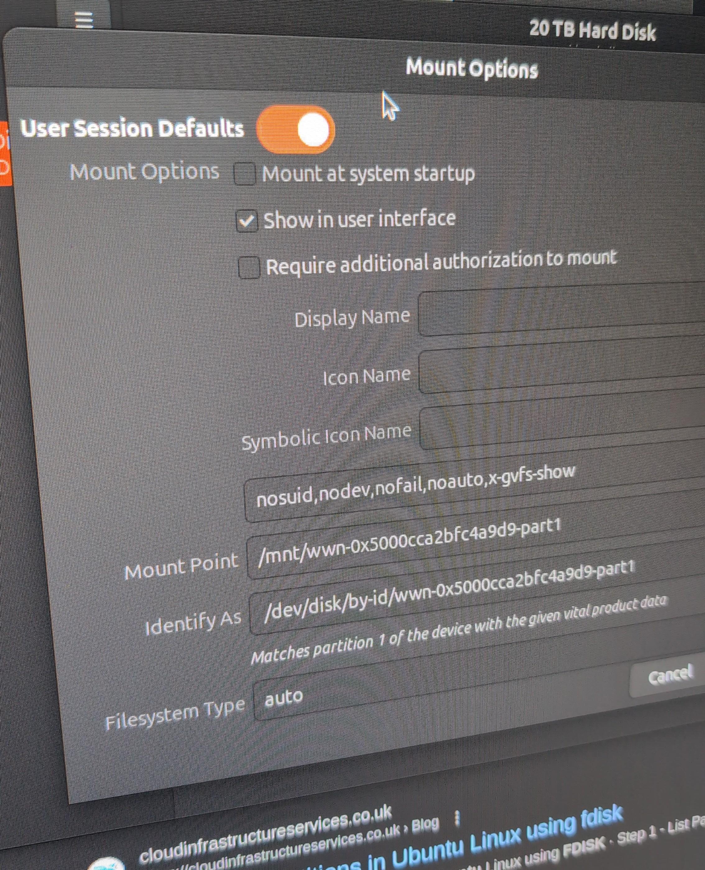

    Where it says, "mkdir /path/to/config" and "mkdir /path/to/cache", I just manually created 2 folders on the Desktop called "conf" and "cache". Do I still use the mkdir commands there if I manually did it? Did I name them correctly, or does it matter?
    My goal is to plug in my external hard drive and always have my JF server recognize & mount that drive and allow JF, which is in Docker, to access it at all times.

    Couldn't I just uncheck "User session defaults" here and just check the "Mount at system startup" box?

    Quote:Couldn't I just uncheck "User session defaults" here and just check the "Mount at system startup" box?

    Fstab is the way to go.
