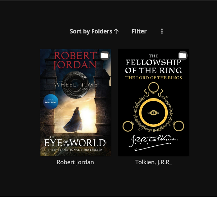

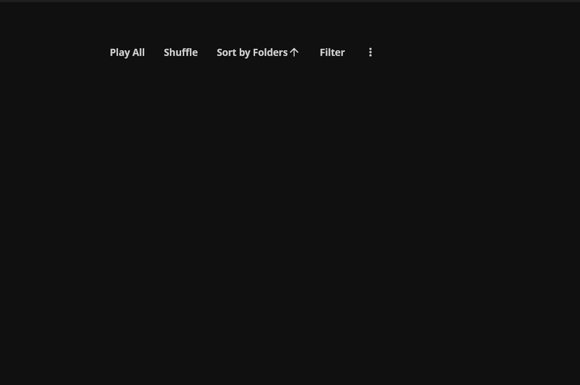

    The book library shows the Author folder which I can click into, and see the folder for the book. Then when I select that I get nothing but an empty folder view. Did I set something up wrong?
    I've attached images below for reference.

    What format are the books in? Does Jellyfin have permissions to read the files?

    (2024-03-08, 06:18 PM)TheDreadPirate Wrote: What format are the books in?  Does Jellyfin have permissions to read the files?
    They are epub files and jellyfin does have permission to the files/folders.

    What are some book file name examples? Having trouble finding anything related to books in the log. Also, you have a lot of ffmpeg failures. What's going on with that?

    So after digging more into permissions as you previously mentioned I decided to go a little crazy and made a new user and got their new ids for users and groups. Moved everything to a new folder share and reapplied permissions. That seems to have fixed everything. (Which is odd because the previous user was shown as having permission)
