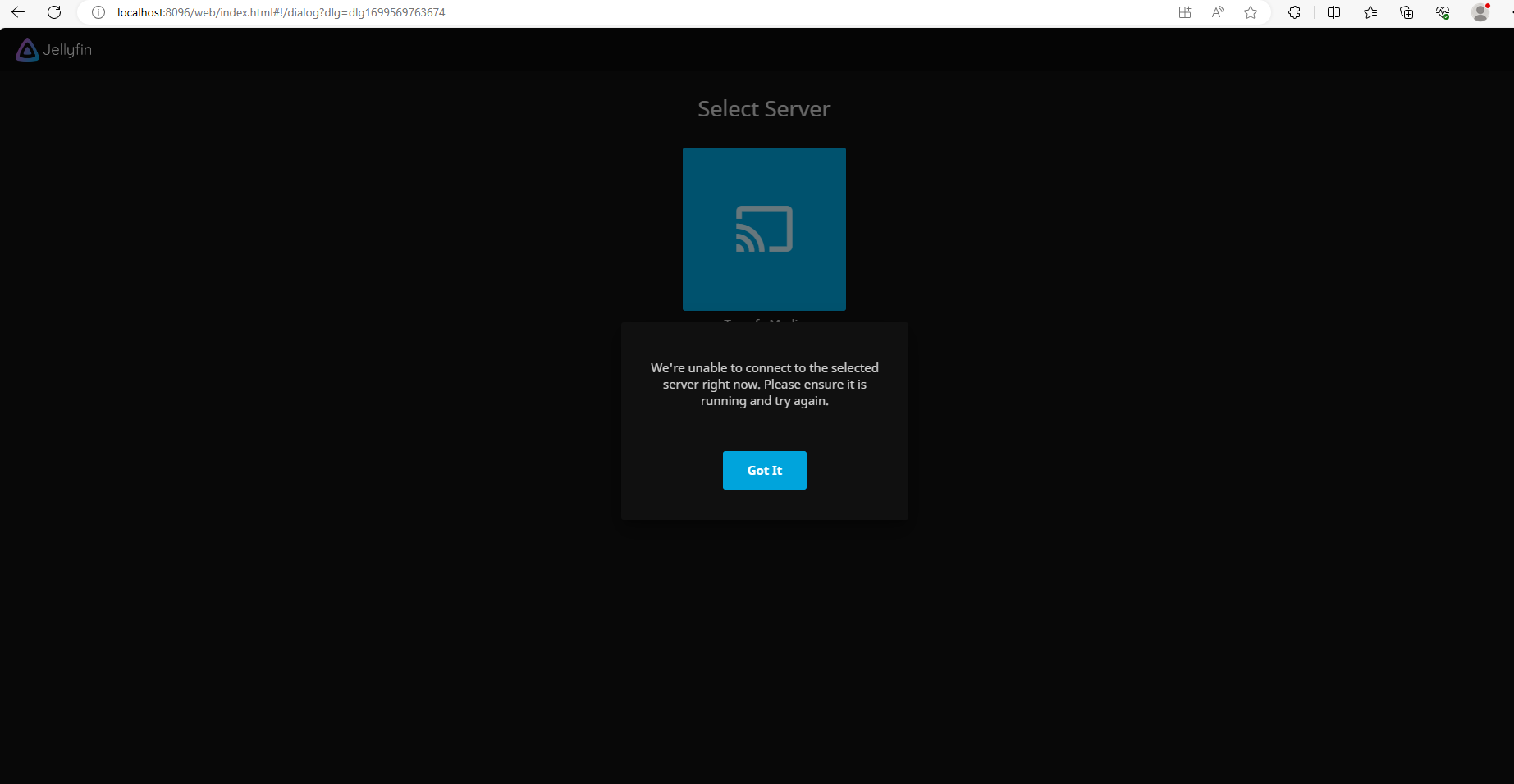

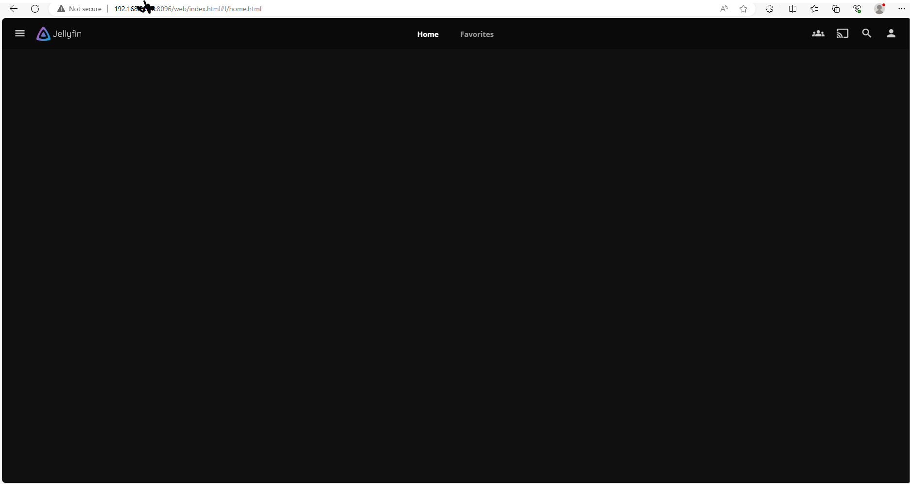

    I recently attempted to update my Jellyfin and it had an issue so I aborted and then reset my system and confirmed that the server was turned odd before trying again and the update went through but when I try to open the server it is unable to connect at this time (even on the host device!) And I rechecked all of my fire wall, rules, I copied my configuration file from my backup of before the update. Even stranger is that even if I turn off Jellyfin if I go to my local 192.168.x.x instead of localhost:8096 it will open a jellyfin that is from my host but doesn't have any of my config saved or users/libraries. Along with this I have a tailscale and wirh the tailscale on it still only responds to the 192.168.x.x despite me being able to ping the 10.x address. I really don't want to have to remake the server and am hoping someone can help.
    Root directory also is still showing my libraries if that is of importance

    I ran the uninstaller and then installed .12 and it appears to of properly copied all my files but the GUI is still not able to be accessed on the host device and Http:localhost:8096 will pull up the choose a server page still (but if my server is selected it cannot connect) while my IP address without tail scale (but the tail scale address will respond to a ping) pulls up a seperate server that as far as I can tell is interacting with my hard drives but not the server I have saved in my files and I'm unsure as to where it is saving files

    images to show what I am speaking of
