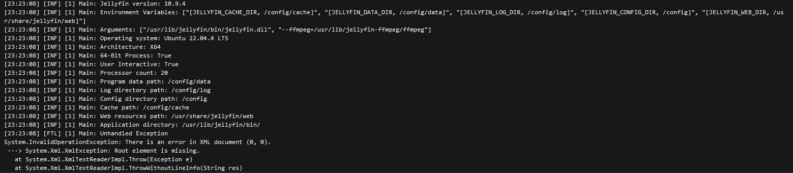

    [23:23:08] [INF] [1] Main: Jellyfin version: 10.9.4
    [23:23:08] [INF] [1] Main: Environment Variables: ["[JELLYFIN_CACHE_DIR, /config/cache]", "[JELLYFIN_DATA_DIR, /config/data]", "[JELLYFIN_LOG_DIR, /config/log]", "[JELLYFIN_CONFIG_DIR, /config]", "[JELLYFIN_WEB_DIR, /usr/share/jellyfin/web]"]
    [23:23:08] [INF] [1] Main: Arguments: ["/usr/lib/jellyfin/bin/jellyfin.dll", "--ffmpeg=/usr/lib/jellyfin-ffmpeg/ffmpeg"]
    [23:23:08] [INF] [1] Main: Operating system: Ubuntu 22.04.4 LTS
    [23:23:08] [INF] [1] Main: Architecture: X64
    [23:23:08] [INF] [1] Main: 64-Bit Process: True
    [23:23:08] [INF] [1] Main: User Interactive: True
    [23:23:08] [INF] [1] Main: Processor count: 20
    [23:23:08] [INF] [1] Main: Program data path: /config/data
    [23:23:08] [INF] [1] Main: Log directory path: /config/log
    [23:23:08] [INF] [1] Main: Config directory path: /config
    [23:23:08] [INF] [1] Main: Cache path: /config/cache
    [23:23:08] [INF] [1] Main: Web resources path: /usr/share/jellyfin/web
    [23:23:08] [INF] [1] Main: Application directory: /usr/lib/jellyfin/bin/
    [23:23:08] [FTL] [1] Main: Unhandled Exception
    System.InvalidOperationException: There is an error in XML document (0, 0).
    ---> System.Xml.XmlException: Root element is missing.
      at System.Xml.XmlTextReaderImpl.Throw(Exception e)
      at System.Xml.XmlTextReaderImpl.ThrowWithoutLineInfo(String res)
      at System.Xml.XmlTextReaderImpl.ParseDocumentContent()
      at System.Xml.XmlReader.MoveToContent()
      at Microsoft.Xml.Serialization.GeneratedAssembly.XmlSerializationReaderMigrationOptions.Read4_MigrationOptions()
      at System.RuntimeMethodHandle.InvokeMethod(Object target, Void** arguments, Signature sig, Boolean isConstructor)
      at System.Reflection.MethodBaseInvoker.InvokeWithNoArgs(Object obj, BindingFlags invokeAttr)
      --- End of inner exception stack trace ---
      at System.Xml.Serialization.XmlSerializer.Deserialize(XmlReader xmlReader, String encodingStyle, XmlDeserializationEvents events)
      at System.Xml.Serialization.XmlSerializer.Deserialize(XmlReader xmlReader)
      at Emby.Server.Implementations.Serialization.MyXmlSerializer.DeserializeFromStream(Type type, Stream stream)
      at Emby.Server.Implementations.Serialization.MyXmlSerializer.DeserializeFromFile(Type type, String file)
      at Jellyfin.Server.Migrations.MigrationRunner.RunPreStartup(ServerApplicationPaths appPaths, ILoggerFactory loggerFactory)
      at Jellyfin.Server.Program.StartApp(StartupOptions options)
      at Jellyfin.Server.Program.<Main>(String[] args)
    Unhandled exception. System.InvalidOperationException: There is an error in XML document (0, 0).
