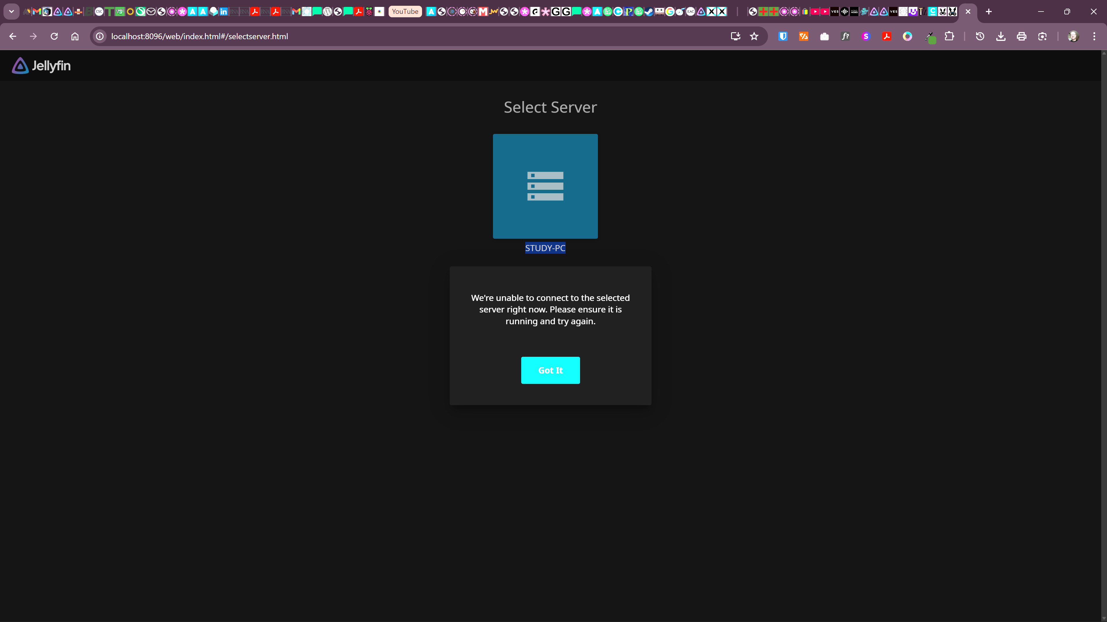

    LandyVlad
    Joined: 2025 Sep
    Country:Australia
    2025-09-30, 01:04 PM
    Thanks. I revoUninstaller and got rid of it and reinstalled from exe file.
    Now getting cant connect to a server. I'm a bit confused will need to read up on it more.
    Cheers

    You most likely need to clear your cache. Try opening the page in a private browser window.
    LandyVlad
    Joined: 2025 Sep
    Country:Australia
    2025-10-01, 01:40 AM
    Um well if I open in incog it just shows same thing but instead of name of PC it just has 'undefined' and its no clickable at all,. so no error.
    It's odd because it's like I'm trying to start a server and it wants me to connect to a server. How do I start the server in the first place?
