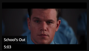

    For example, here's the first chapter from The Departed
    • In Jellyfin, the app seems to use the correct iframe.

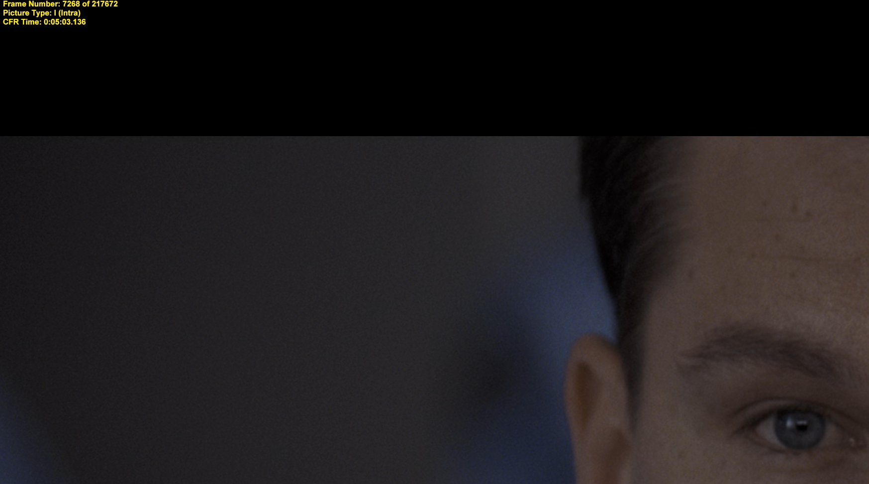

    AviSynth (AvsPmod) : Frame 7268

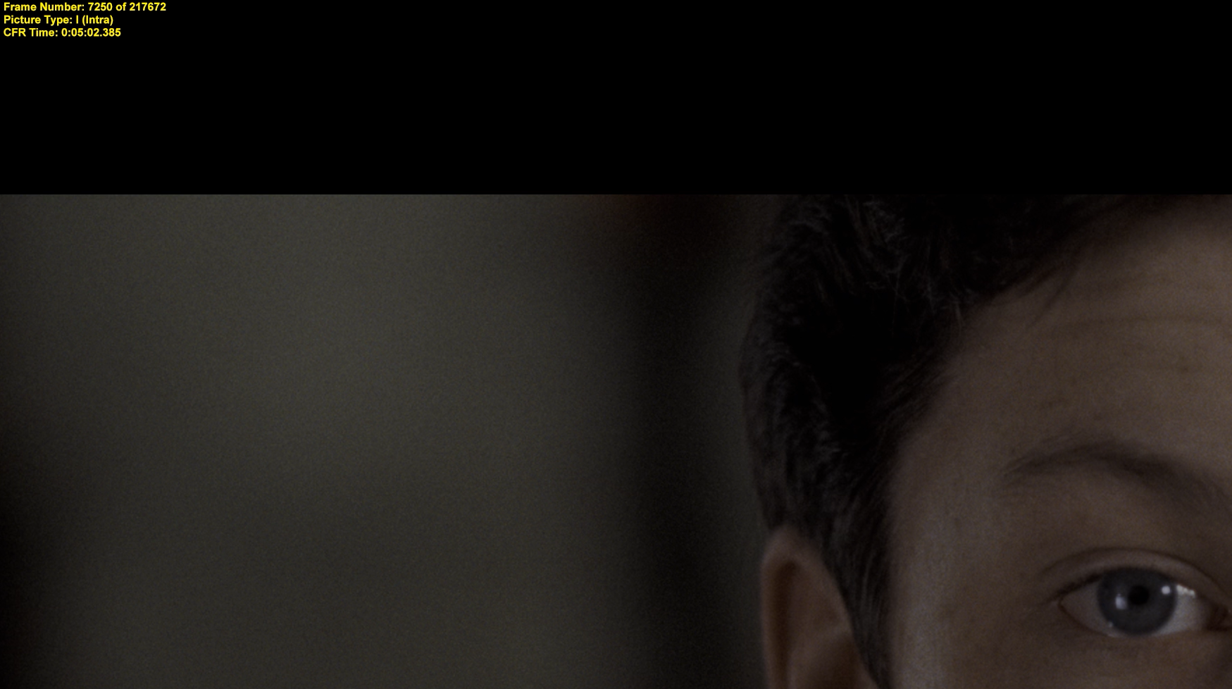

    Kodi : (I don't have the exact Kodi screenshot, but this is the frame I can see) Frame 7250

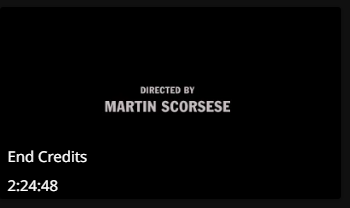

    For example, here’s the end credits chapter :

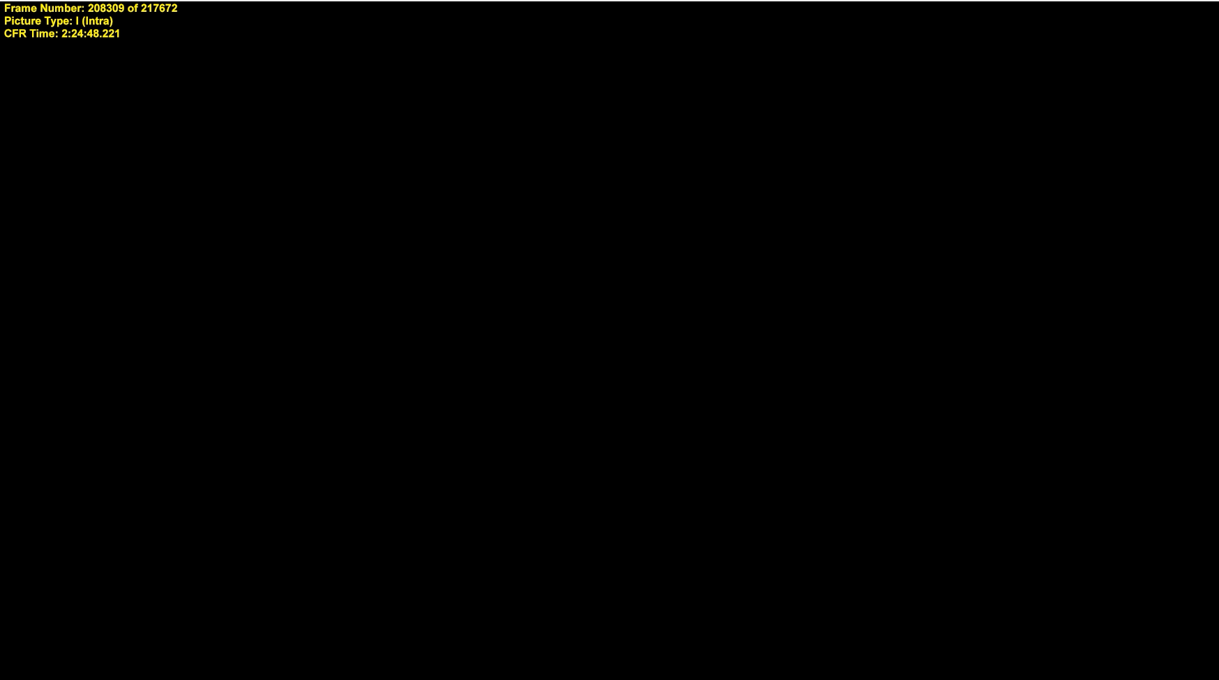

    AviSynth (AvsPmod) : Frame 208309

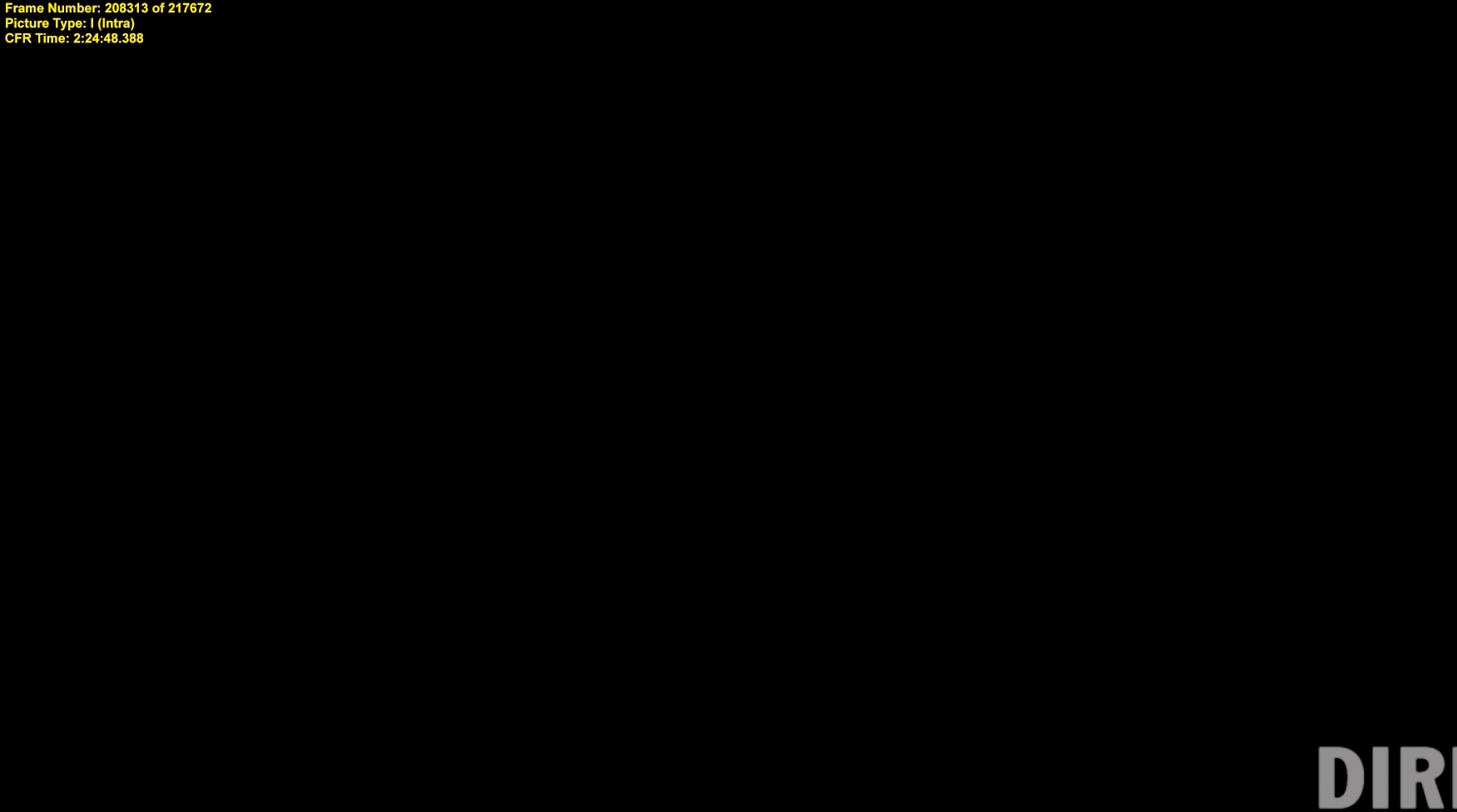

    Jellyfin : Frame 208313 I guess
    MKVToolNix Chapter :
    So in both players I get different behavior, and sometime it seems Jellyfin pick up the next iframe.
