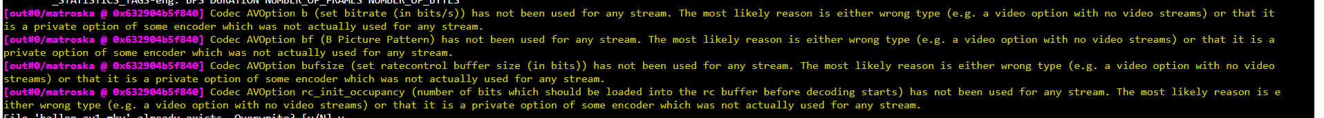

    BUT it seems is only a file with audio :-(   (also again not activity in intel_gpu_top)
    Do i need to setup which Codec the Input stream is ? in this case it would be  1080p H264 SDR
    It seems that codec is not regognized (see picture)
    Ciao Gerd

    2025-01-29, 04:43 PM (This post was last modified: 2025-01-29, 04:44 PM by TheDreadPirate. Edited 1 time in total.)
    We forgot to map the video. lol
    -map 0:v
    You could also simply do this to map all input streams to the output file. You'd remove all the per stream type mappings and replace it with this.
    -map 0
    If you are specifying a mapping per stream type, you should also add this to ensure you also grab all the attachments, often fonts for text based subtitles.
    -map 0:t?
    /usr/lib/jellyfin-ffmpeg/ffmpeg -fflags +nobuffer+discardcorrupt+genpts+flush_packets -init_hw_device vaapi=va:,driver=iHD,kernel_driver=i915 -init_hw_device qsv=qs@va -filter_hw_device qs -hwaccel qsv -hwaccel_output_format qsv -extra_hw_frames 40 -i ballon.1080p.mkv -map 0:v -c:v av1_qsv -preset veryslow -extbrc 1 -low_delay_brc 1 -look_ahead_depth 40 -b:v 1M -bufsize 2M -rc_init_occupancy 512K -adaptive_i 1 -adaptive_b 1 -b_strategy 1 -bf 7 -map 0:a? -c:a copy -map 0:s? -c:s copy -map 0:t? -max_muxing_queue_size 2048 -max_interleave_delta 0 -avoid_negative_ts disabled ballon.av1.mkv
