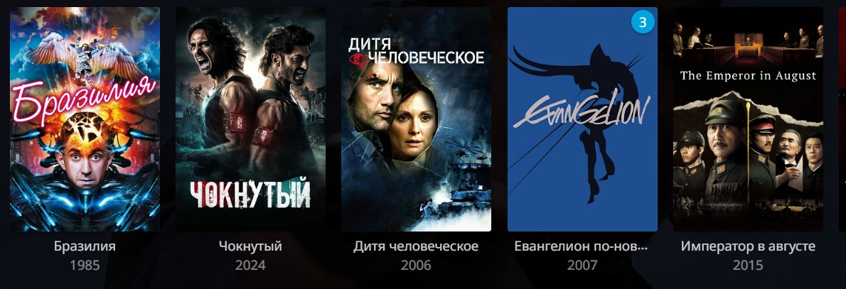

    I confirm. Sorting by name in Cyrillic occurs through sorting by name in Latin. That is, transliteration is used from Latin characters.
    For example:
    lat A - cyr А;
    lat B - cyr Б;
    lat С - cyr Ч;
    lat D - cyr Д;
    lat E - cyr Э;
    lat F - cyr Ф;
    lat G - cyr Г;
    Etc...
    This does not correspond to the Cyrillic alphabetical order.
    А Б В Г Д Е Ё Ж З И Й К Л М Н О П Р С Т У Ф Х Ц Ч Ш Щ Ъ Ы Ь Э Ю Я
