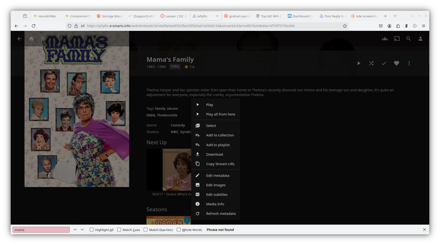

    I can watch recording even, but I am not sure how to delete an episode from the UI.  I am using webui and roku ATM, an dI can watch, download and everything else, but no delete..
    is there a way to do that other than the filesystem itself?

    Also, regarding deleting recordings, as long as you have sufficient you click on the "..." context menu for the episode and "Delete episode".
    I don't remember off the top of my head of we enabled media management from Roku devices.

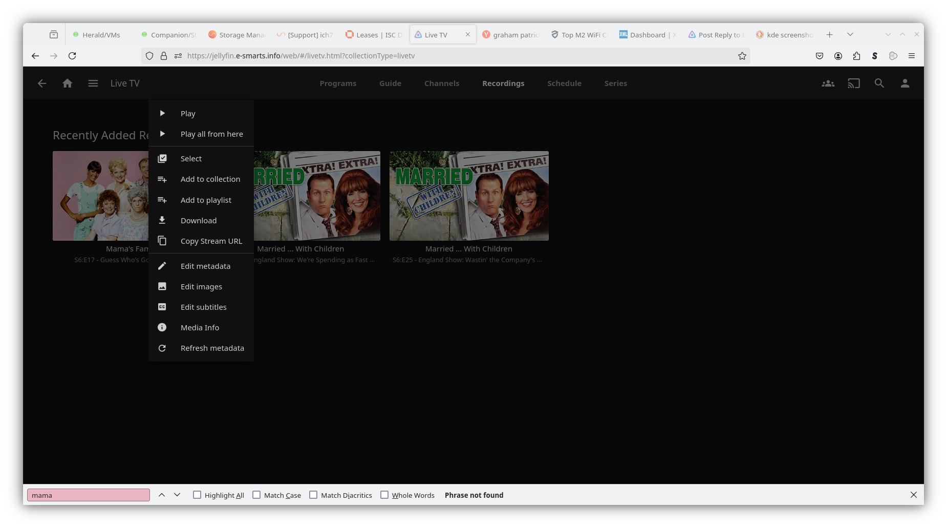

    Hiya - Thanks for the reply Smiling-face  So I just tried playing a recording on the web ui, and it failed again.  It seemed to generate 3 separate ffmpeg log files.  Weird.  Those log files are attached.
    Additionally - re: the deleting of episodes, I added a few screenshots showing that I do not appear to have that option, and threw one in showing the only live tv settings I noticed in user management.
    Ok so that being neither here nor there, I just tried using my phone to stream that episode while I was writing this.  My android phone with (i assume) the latest client started playing the show immediately, so I guess that means it's a me thing.  I tried both Chromium and Firefox and received the same response.  Also use two different profiles.  It's a puzzler.

    Scroll down a bit more in the User dashboard.  Is media deletion not enabled for that library?

    Hiya - I'll try the remux a but later, thanks for the suggesion.  I wonder why the phone would direct play and the web would not.  I would have assumed the web would have more codecs or whatnot.  Eh whatever, I'll try  Smiling-face
    It says I have delete access to all libraries...  Tho to be honest I've never really used that function.  I'm sure it's handy, but when I did use it once, It deleted the file, but not all the associated schmutz, some of which JF made, some was from tmm or whatever, and of course the directory still existed.   All makes sense, can't have the server just blindly deleting a bunch of stuff it didn't make.  that could end up a nightmare lol.  I can still manage from the filesystem just fine, just thought the option might exist in a parity with my average tivo/dvr.  Understood this is far more magic and hope than that dedicated system so it's all good.
