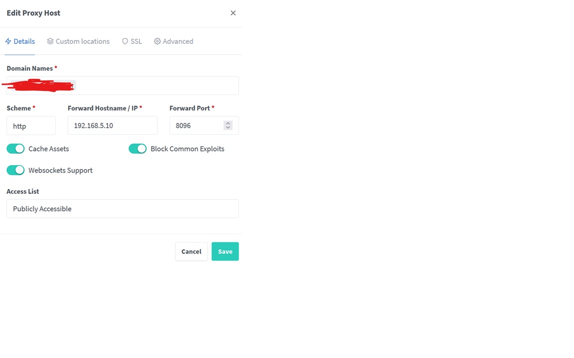

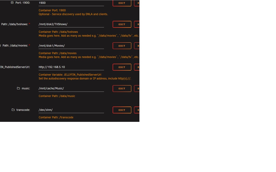

    2025-02-26, 09:54 PM (This post was last modified: 2025-02-26, 09:55 PM by FaptainCrunch7. Edited 2 times in total.)
    Added 4 pics for various JF and NPM configs.
    Reputation: 462
    2025-02-26, 11:07 PM
    Turn off "cache assets" in NPM. That can cause a lot of issues with jellyfin, even when direct playing. There is no benefit to it being on and it just consumes a lot of resources.
    Unrelated, passing in your GPU via the extra arguments PROBABLY works fine. The "right" way is to click on "Show more settings" and there is an explicit "Devices" field to pass in /dev/dri.

    Thanks for the NPM tip! NPM shouldn't be the issue if im just mapping the client while home direct to Jellyfin via local IP while at home though, correct?
    Reputation: 462
    2025-02-27, 01:43 PM
    If you're going directly to port 8096, it would bypass Nginx.
    Let's try this. Remove port publishing in Jellyfin. Reconfigure Nginx to proxy Jellyfin's bridge IP (172.16.0.6). Have ALL clients go to the domain address.
    To improve the experience for local clients, you should enable NAT loopback if your router supports that. If not, most routers should allow you to add custom DNS entries. You would add a DNS entry to resolve your domain name to your host's LAN IP. I prefer just doing custom DNS entries, in general, so that my domain name still works for LAN clients if the Internet were to go out.
    What we're trying to do is reduce the number of context changes that is going on for network traffic. Going from host network to bridge network to host network to bridge network, and then again in reverse.
