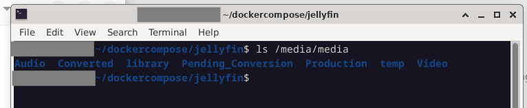

    If the mount is present on the host, docker will find it. This is not a Jellyfin issue per se, but we can probably help. What do you get when you ls /media/media?

    (2025-07-23, 05:36 PM)bitmap Wrote: If the mount is present on the host, docker will find it. This is not a Jellyfin issue per se, but we can probably help. What do you get when you ls /media/media?
    This is kind of what I thought, so I'm not sure what the hangup is. I definitely appreciate the help as I'm still learning Docker and my Linux skills are not particularly refined.
    When I ls /media/media I get a list of folders from the server that the SMB share is linked to.
