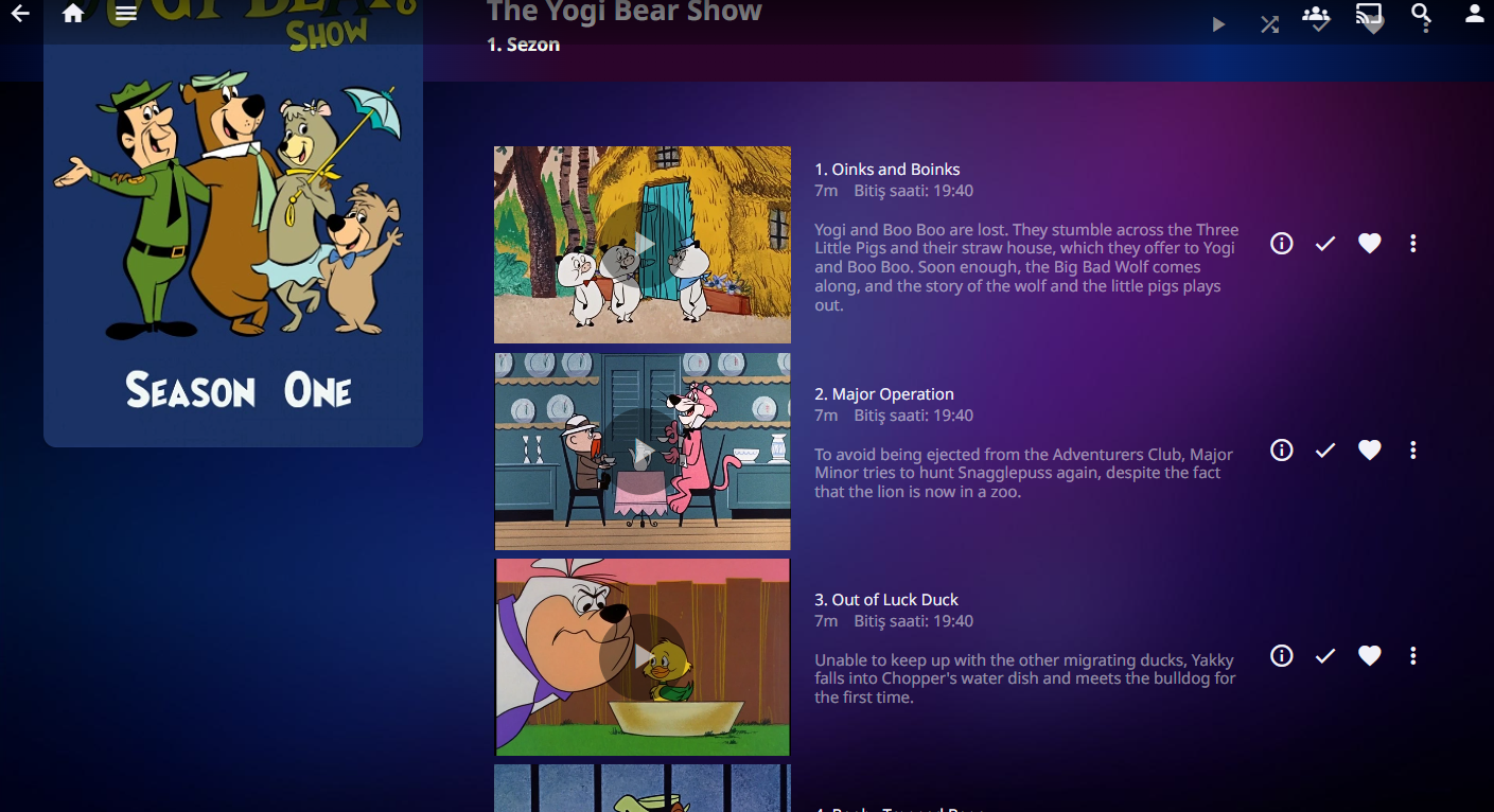

    2024-06-26, 04:40 PM (This post was last modified: 2024-06-26, 08:40 PM by dreamon. Edited 17 times in total.)
    dvd ordering works absolutely fine, i am using the latest v10.9.7 build with TVDB plugin installed. it was working with previous builds as well.
    added some screenshots from my own server to show the dvd order working for three animated series.
    i was the one who added the dvd orderings of both "the catannoga cats" and "the yogi bear show" to tvdb and they show up as they should be Smiling-face
    third screenshot is animé series Monogatari which has 4 different orders on TVDB.
    there must be something wrong with your configuration or the way you renamed the files.
    are you sure you named the files the way tvdb does and then selected dvd order from the shows's metadata settings? if so, you have to fully refresh the metadata (including changing current images) to make the new ordering appear.
    Filebot can rename the episodes easily to match dvd order if you have so many files.
