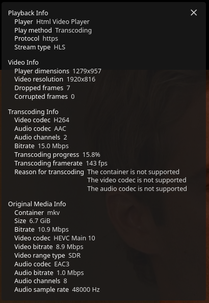

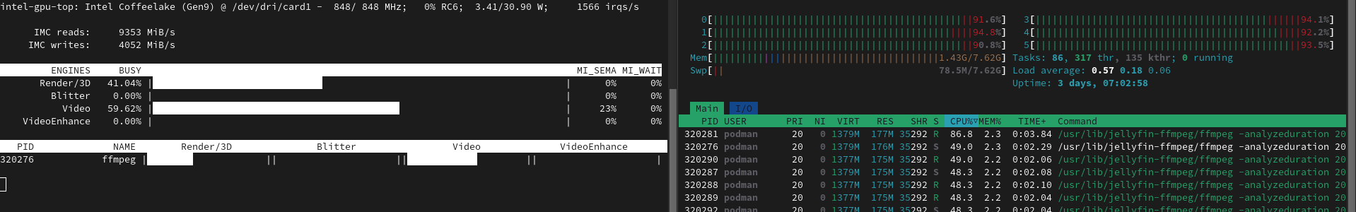

    Whenever I try watch a movie that needs to be transcoded it looks similar to the attached gif.
    The png attachment shows what it the movie is being transcoded to.
    The peak load I've seen so far was at 9 which is obviously not ideal with a 6 core processor.
    Is this kind of CPU load expected even WITH hardware acceleration?

    The transcoding speed is fine. Your system is transcoding at 143fps from your picture.
    The issue is that your client is dropping frames. You have 7 dropped frames recorded in the picture. Are you using the same system to play the video as what the server is installed on?

    (2024-06-25, 09:05 PM)Efficient_Good_5784 Wrote: The transcoding speed is fine. Your system is transcoding at 143fps from your picture.
    I was more asking about the amount of resources required on the server side. The video playback itself is fine (apart from an audio desync issue but I don't think those two issues are linked).
    (2024-06-25, 09:05 PM)Efficient_Good_5784 Wrote: The issue is that your client is dropping frames. You have 7 dropped frames recorded in the picture. Are you using the same system to play the video as what the server is installed on?
    I'm watching the video via Firefox in my main PC which is a different machine

    (2024-06-25, 09:13 PM)DailyBadger5423 Wrote: I was more asking about the amount of resources required on the server side. The video playback itself is fine (apart from an audio desync issue but I don't think those two issues are linked).
    Ohh sorry. I misread your first post and thought you meant the playback looked like a GIF.
    From what your server specs are, that does seem normal. While the video can be sent to the iGPU to transcode it, the audio has to be sent to the CPU cores to transcode that. So since the CPU you're using is on the lower-end in terms of performance, having a higher CPU utilization is normal.

    2024-06-26, 01:56 AM
    It seems that HEVC 10-bit hw decoder is not enabled, which causes swdec+hwenc. You can enable it in Dashboard->Playback.
