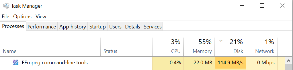

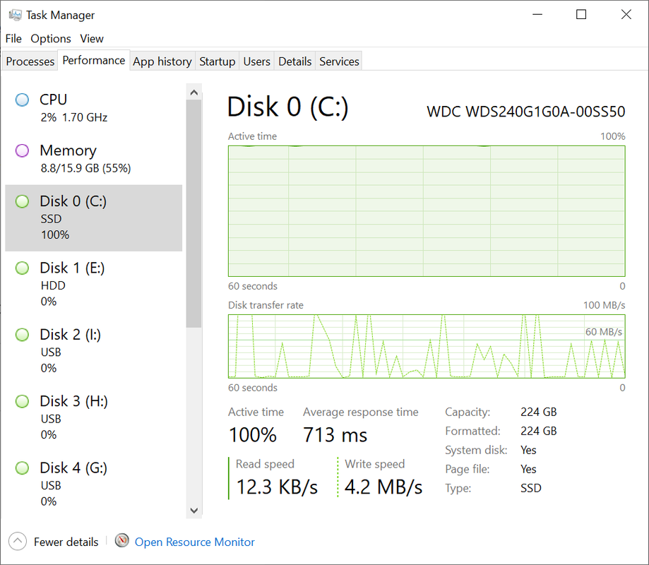

    When I stream some releases whether they're 4K or 1080p, it stops. When I check my PC I find it really heavy and after looking around, I found out that FFmpeg Command-line Tools is hammering my SSD as you can see here
    [Image: Taskmgr-l-MAPj7w-RMv.png]
    [Image: firefox-FAH7ee6j5n.png]

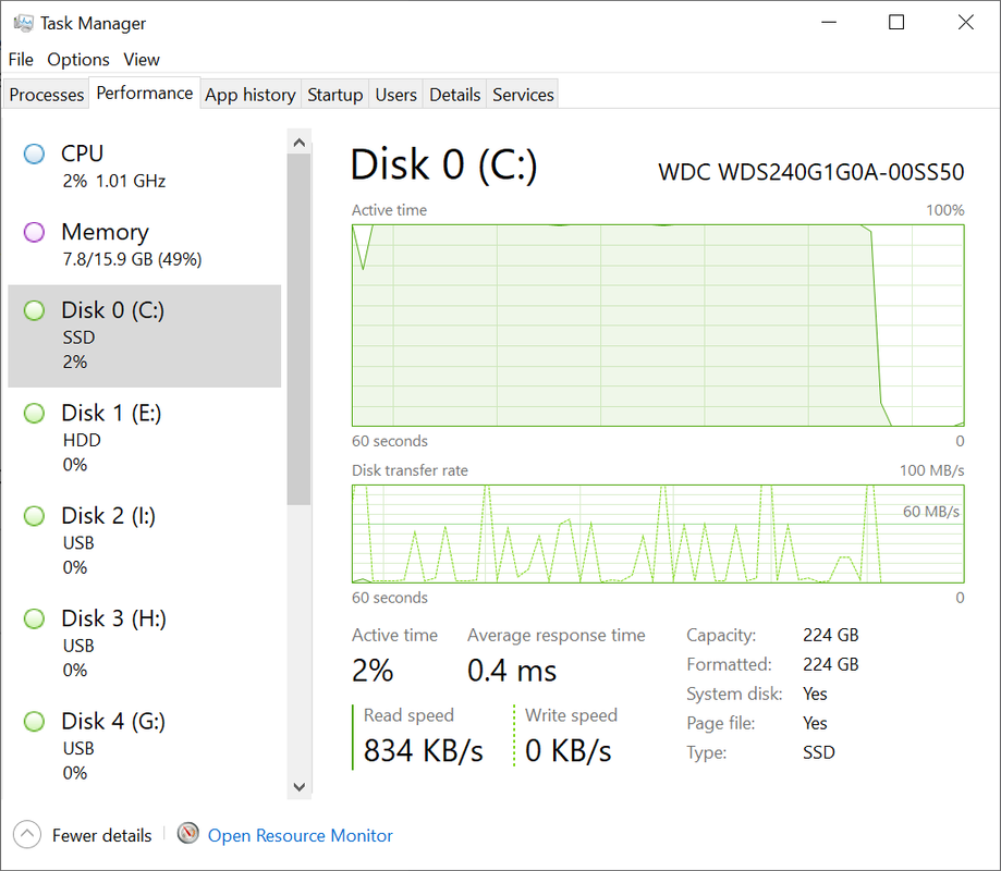

    And this is what happens when I close the stream
    [Image: Taskmgr-xo-Lx-Ohx-VDV.png]

    You are streaming high bitrate contents and ffmpeg is coping those high bitrate stream to its cache. What is the problem with that?

    I still don't understand your question because everything looks normal to me. This is how it should be working. The file you are trying to stream is 24GB in size and ffmpeg will copy the whole 24GB file and it will take some time and could show as high IO usage. But all the above behavior is working as intended.
    What is the actual problem you are having make you believe jellyfin is misbehaving, other than a bit high performance statistics?

    Okay, the thing is, when the stream in LGTV stops, and I go to the server and close FFmpeg Command-line Tools from Task Manger. The stream immediately resume in the client.

    2025-02-08, 11:31 AM
    Welcome to the party then: https://github.com/jellyfin/jellyfin-webos/issues/248
    It is a painful LG WebOS specific issue that many users faced. Some user in this tracker got a seems-to-working workaround but it is still yet to be tested.
