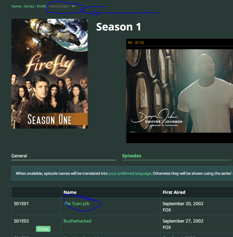

    For the show, click on the context menu "..." and "Edit Metadata". About halfway down the menu is a drop down to select alternate orderings. The Train Job is the first episode of the "Aired" ordering while Serenity is the first episode of the DVD ordering.

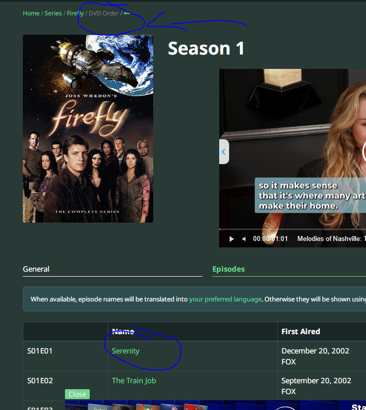

    I'm not sure that's the problem. I already have the series in DVD order.
    Even though the file path is pointing to the correctly labeled episodes, Jellyfin is mislabeling them when I look at the Title and adding the incorrect External IDs.

    I understand that.  The Train Job is the first episode of the AIRED order.  So if you have it set to DVD order, that is the problem. The title you put in the file name does not affect the name in the Jellyfin UI. It uses "s01e01" in the filename, plus the show name in the folder, plus whatever ordering you selected, and pulls down the appropriate episode name from TMDB/TVDB.
