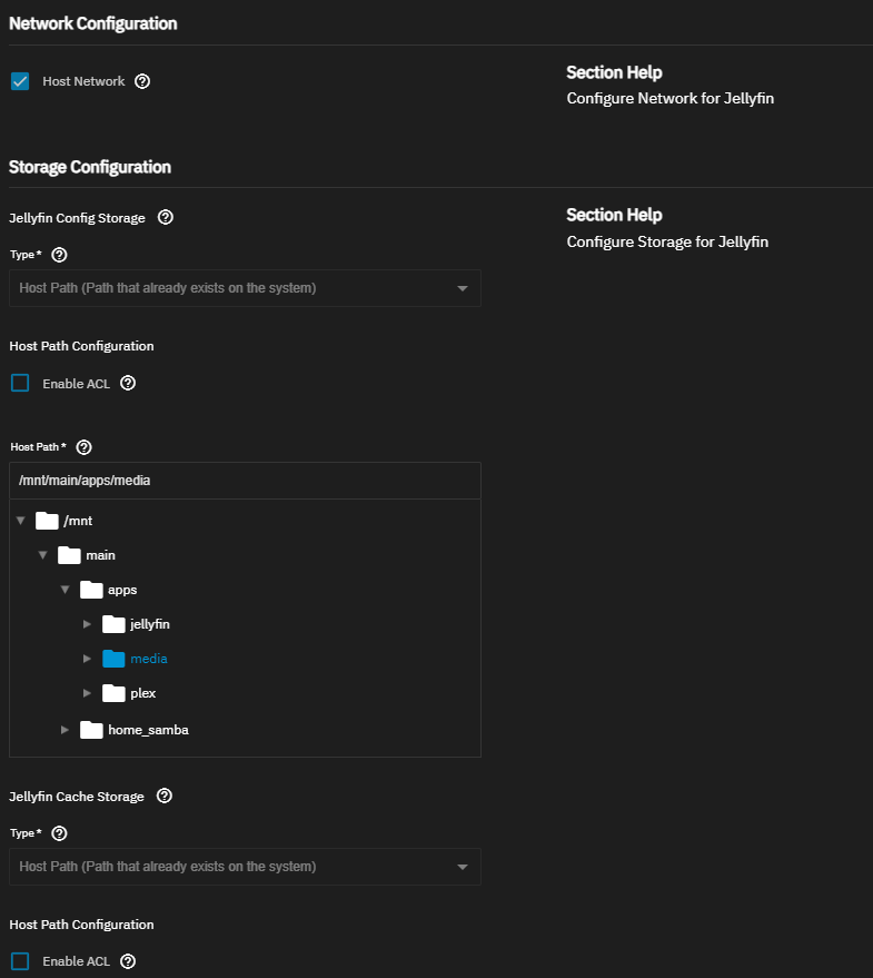

    This is my first time installing jellyfin so I don´t really know what I am doing. I have installed jellyfin as an ´app´ on my NAS running truenas scale.
    I am running version 10.9.6.
    I believe it is running in a kubernete but I´m not super sure.

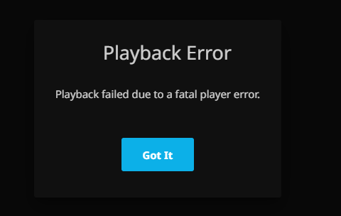

    Whenever I try to playback a movie, I have the error:
    Playback Error
    Playback failed due to a fatal player error.
    I have no idea what might be causing this error, jellyfin correctly syncs the info and I can play all the movies through windows explorer. I tried to open the logs but I am just lost and I don´t see any super obvious errors or codes.
    I have this error using windows 10 brave, chrome on two separate laptops. Also have this issue on android app.
    In the config, I put the exact same media folder for every single of the options. I have made sure that is the right folder.
    Would love help with this.

    2024-06-20, 10:53 PM
    Every ffmpeg log has this.
    [hls @ 0x55b262a90640] Opening '/cache/transcodes/a5199396b6baa91930663150550a438d-1.mp4' for writing
    [hls @ 0x55b262a90640] Failed to open segment 'a5199396b6baa91930663150550a438d-1.mp4'
    [out#0/hls @ 0x55b262a8fb00] Could not write header (incorrect codec parameters ?): Permission denied
    The container likely does not have sufficient permissions to write to /cache. In your container config, did you provide host volumes to mount /config and /cache to?
    dbd
    2024-06-20, 10:55 PM
    Ah, I think that's it. During the install, I didn't really understand what path I had to put so I copied and pasted my media folder for all. I'll try to create new folders for the cache and config and I'll let you know how it goes.
