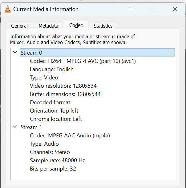

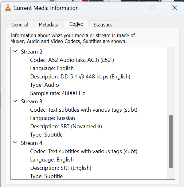

    Greetings.
    I have a weird situation and being a total noob with Jellyfin I'm at loss at where and what to dig for. Any input on finding out the reason of the issue is appreciated.
    ===Issue(s)===
    Both videos in questions can be viewed via web client from a computer.
    When trying through a TV (Hisense) via DLNA the first video runs fine.
    The second video changes the screen to playback screen with black screen instead of the image and a toast message "File not supported" appears. Both toast and playback screen disappear and it's back to folder menu.
    Issue #2 - for troubleshooting, to exclude issues with filepath I moved both test files in a same test folder. Did library scan. None of the files can be played on TV, including the one which runs fine in its original location. I mean for both videos I have the "file not supported" scenario.
    ===Setup===
    Jellyfin v10.9.7 runs on a Proxmox VE in a LXC container (before that I tried it in a docker on a LXC on the same Proxmox with same issue there).
    Media is a on OMV SMB share which is mounted on Proxmox host and granted to LXC container.
    Proxmox runs on a Dell Optiplex 5060 (not sure if that's relevant though).
    Video files' codecs info is in the screenshots attached.
    First video is played fine with no entries in jellyfinlog.
    Log entries from jellyfinlog on attempt to plaz second video are in the screenshot.
