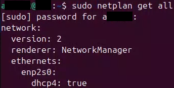

    #15
    2025-01-22, 10:07 PM (This post was last modified: 2025-01-22, 10:09 PM by 4r5hw45twh. Edited 3 times in total.)
    (2025-01-22, 05:46 PM)TheDreadPirate Wrote: Let's try this.  Run this command and share the output.
    sudo netplan get all
    Sorry, was at work and just got home.
    Here is the output attached:
    And yes, latest Ubuntu LTS version. I honestly had no idea there was a specific "Server" variant. Is that what you use?

    #16
    2025-01-22, 11:05 PM (This post was last modified: 2025-01-22, 11:06 PM by TheDreadPirate.)
    I do use the server specific variant. Does not come with a desktop UI by default, has various other minor differences. Like having the MAC randomizer disabled by default.
    Ok. One difference I see is that mine uses netplan natively vs yours using networkmanager.
    Check out /etc/NetworkManager/ and see if there are any conf files that enable MAC ramdomization.
    Also, is your server using WIFI or ethernet? The options I am seeing for MAC randomization primary have to do with WIFI.
    https://networkmanager.pages.freedesktop....conf.html

    (2025-01-22, 11:05 PM)TheDreadPirate Wrote: Ok.  One difference I see is that mine uses netplan natively vs yours using networkmanager.
    Is netplan better or?
    And the conf file there says "no" for the random mac address line. So that's good I guess.
    And the server is Ethernet.
