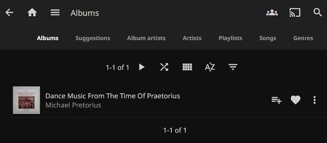

    I seem to have a strange problem with genres when there are multiple music libraries.  I have two libraries that I've created, one for CDs and the other for records.  When I list the albums in either of the two libraries, only the albums in that library show up, but when I go to genres, there are some albums from the other libraries (that are the same genre).  It's not consistent however, only some of the albums (based on genre) from the "Albums" library show up in the "CDs" library and vice versa.

    Here's the list of the Albums library
