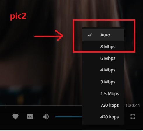

    After the above work is completed, open the WebOS 1.22 app on the TV, play the test video, and use the LG remote control to randomly fast-forward or backward until there is an out-of-sync problem. At this time, press the pause button on the LG remote control (there are two vertical bars), and the playback screen will pause. Use the remote control to move the gear button in the lower right corner of the playback interface to enter the settings, please see pic1; Then select it, enter the interface similar to pic2, select 8Mbps under auto, wait for 2-3 seconds, the test video will automatically continue to play, at this time the subtitles and audio and video will be synchronized. If the synchronization occurs again, repeat the above steps and select auto above 8Mbps.
    As long as you switch between the next option of auto and auto, the video will remain in the original mode and will never trigger the other modes.

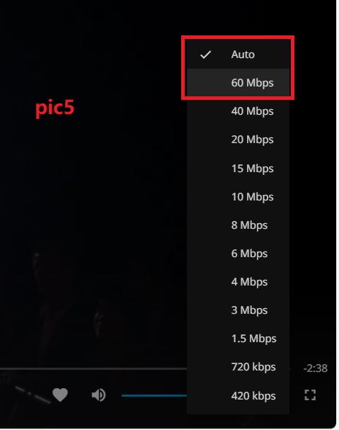

    It should be noted that for different video files, the number below auto may not be 8Mbps but something else, ignore this detail, just switch between auto and the options below auto. See PIC5.
