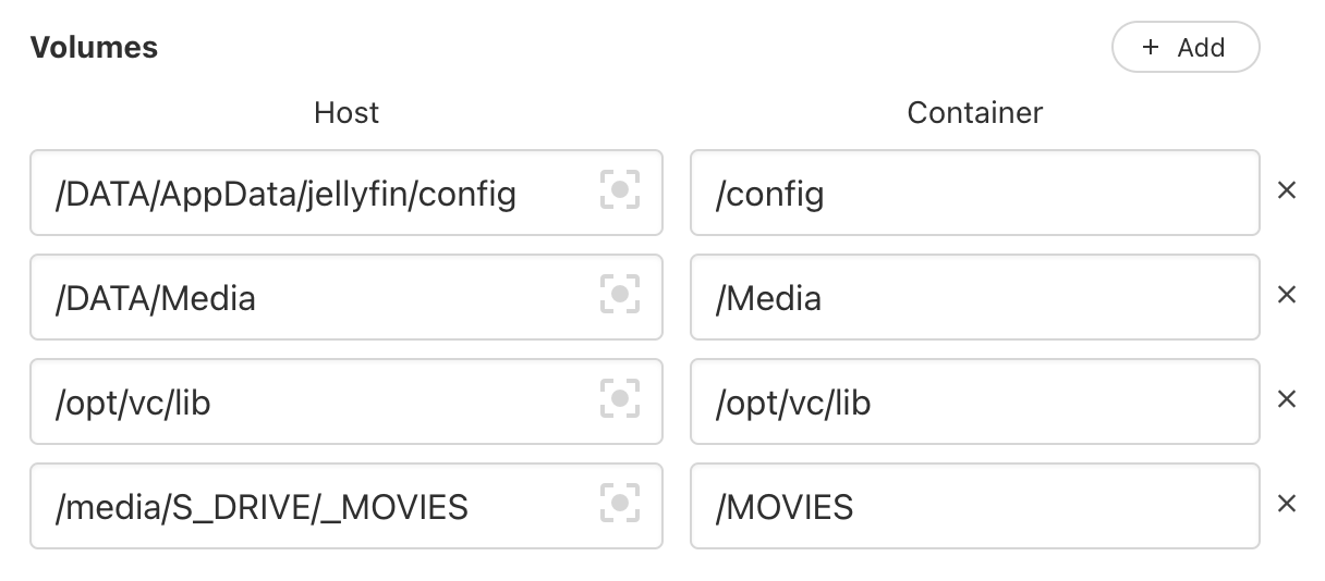

    2023-11-08, 08:17 AM (This post was last modified: 2023-11-08, 08:20 AM by tezza. Edited 1 time in total.)
    I had the same problem and solved it.
    The reason is because all the casa apps are installed via docker containers. Each container needs the desired folder (to be accessed) to be mapped as a volume in the container's internal virtual file system.
    You can add a volume mapping by clicking the 3 dots (then "settings") of the app from the casa dashboard to edit it's docker container.
    The screenshot shows how I added an entry for my external drive (last entry).

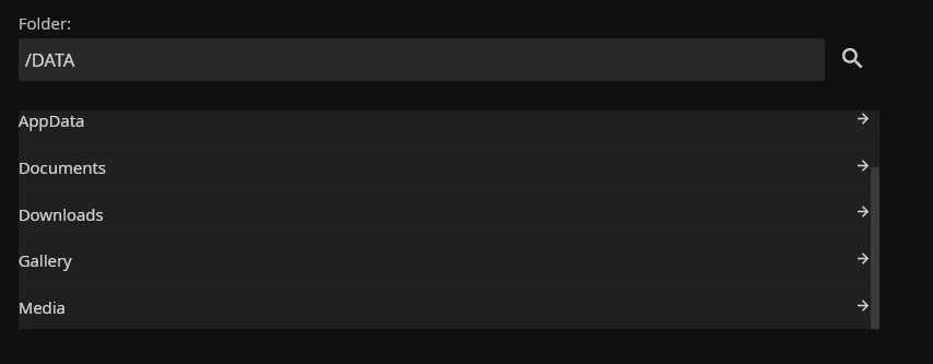

    Actually, for some reason I have a /data and a /DATA and it looks like Jellyfin can only see the latter in the root folder. Is Jellyfin's ability to read paths not case sensitive? It's possible the reason I have two is because I goofed when I tried to make the symlink in the first place, so I tried making a symlink in /DATA, but even after restarting Jellyfin and then rebooting the machine, it can't see Library in /DATA. I tried to add a hardlink in /DATA, but it says that's not allowed for the directory (I tried deleting the symlink and that wasn't the problem). Code is what I can see in terminal, attached image is what I see in Jellyfin.
    root@odroidxu4:/DATA# dir -al
    total 28
    drwxrwxrwx  7 root  root  4096 Nov 18 15:10 .
    drwxr-xr-x 26 root  root  4096 Oct 11 22:03 ..
    drwxrwxrwx  7 root  root  4096 Oct 11 22:11 AppData
    drwxrwxrwx  2 root  root  4096 Jul 16 15:16 Documents
    drwxrwxrwx  5 peter peter 4096 Jul 16 15:35 Downloads
    drwxrwxrwx  2 root  root  4096 Jul 16 15:16 Gallery
    lrwxrwxrwx  1 root  root    29 Nov 18 15:10 Library -> /media/devmon/Library/Library
    drwxrwxrwx  6 root  root  4096 Aug 25 18:48 Media
    This system is an ARM7 board using a microSD card as the boot drive and the media I want to add to the library is on an HDD connected to the board by internal SATA. I'm starting to suspect that Jellyfin for some reason only has access to the SD card.
