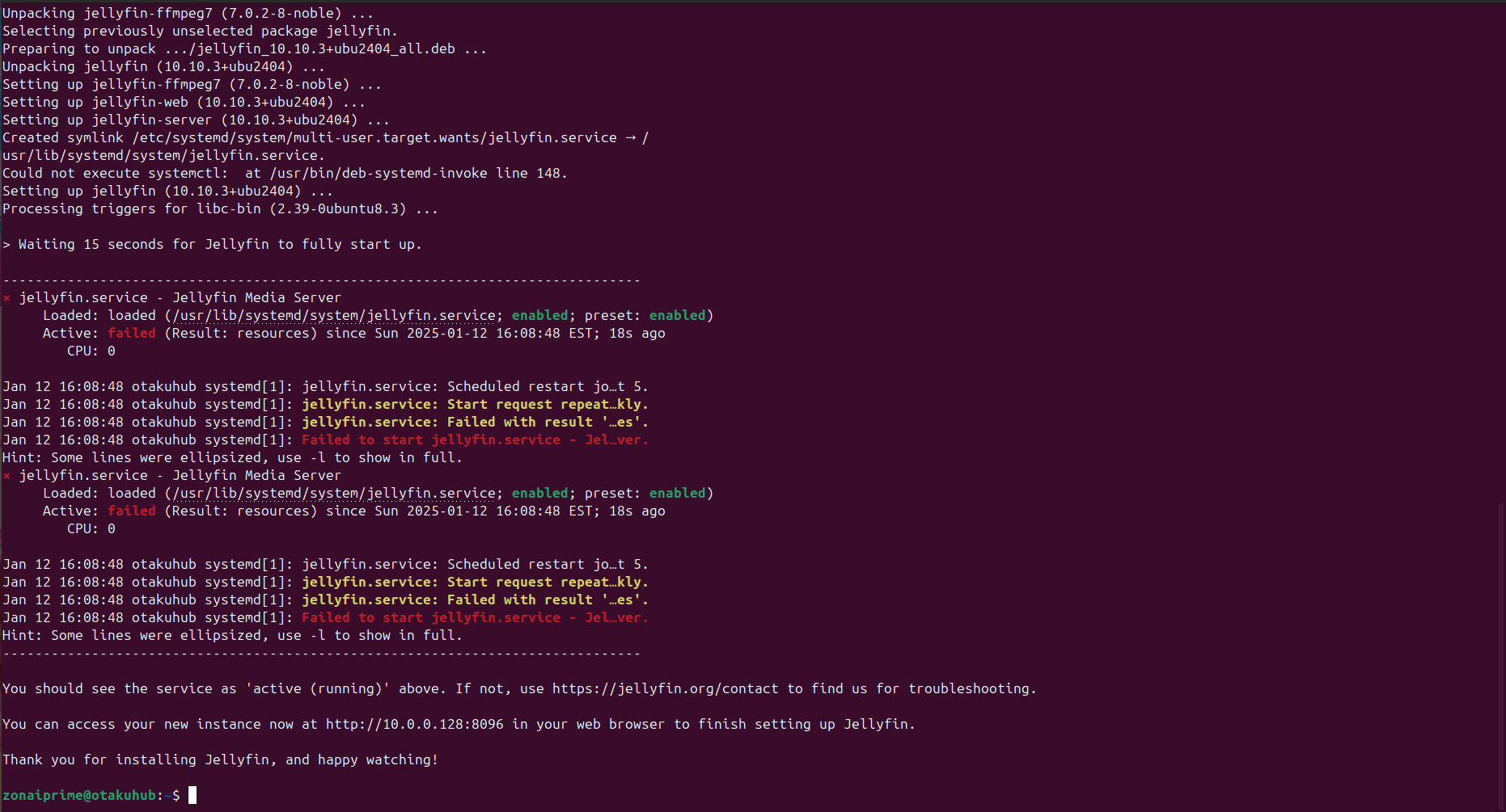

    I recently started using jellyfin. and at first things were going smoothly, until i was fooling around with the ports. i changed the port from the default 8096 to 25565. when i restarted the server. it would stop right after i type sudo systemctl restart jellyfin.service. I the used apt remove jellyfin* to remove it from my system. then i did  fresh install using jellyfins official guide. now i get a faild to exucute error. it says the result is resources. idk what that means, and im very new to using media servers in general.

    gotcha. that does sound better than reinstalling it. what should i do from here.  cant find that file in /etc/jellyfin/  How can i go about uninstalling and restarting fro scratch or would it be better to just try and find the network file and change the port manually?

    2025-01-12, 11:28 PM
    Is there anything in /etc/jellyfin? Does the jellyfin directory exist in /etc?
