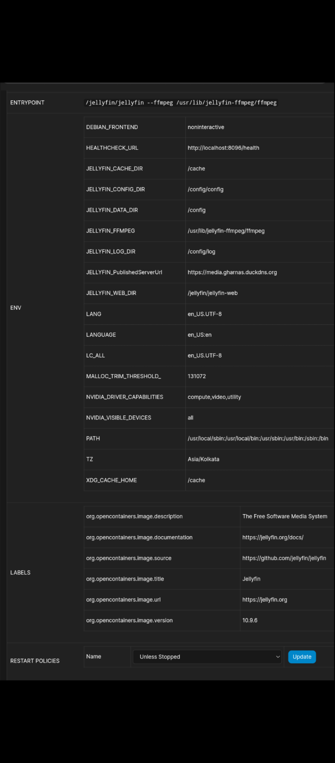

    Can you check if you have DOTNET_SYSTEM_GLOBALIZATION_INVARIANT set in docker?
    fedonr
    Posts: 21
    #16
    2024-06-17, 03:35 PM
    (2024-06-17, 02:48 PM)TheDreadPirate Wrote: Can you check if you have DOTNET_SYSTEM_GLOBALIZATION_INVARIANT set in docker?
    No I checked it doesn't exist
