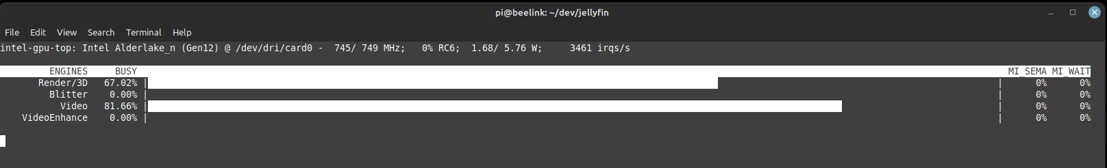

    Looking to understand which settings I should chose for the hardware acceleration on my Beelink server. I have everything up and running (using docker-compose, see .yml), but am just unsure if I'm supposed to pick low power, QSV, or VA-API. I'm also not sure about which codecs to have enabled versus disabled. I have provided as much detail below after having went through the Intel hardware-acceleration docs. Is my assumption that it appears to be VA-API? I have tried first with QSV and brought down the bitrate to 1.5 Mbps and saw the output of intel_gpu_top change (screenshot attached). Just not sure how to pick the optimal settings or what makes most sense.
