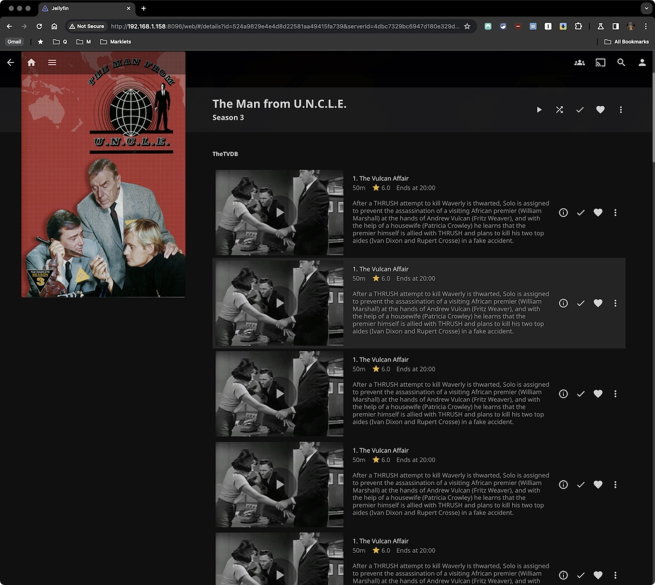

    Encountered an odd issue with the metadata for a specific TV show.

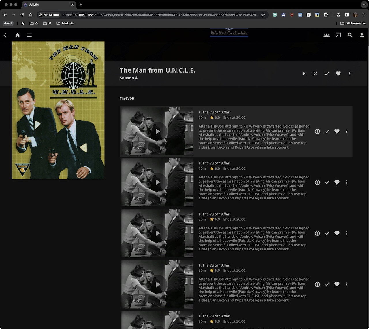

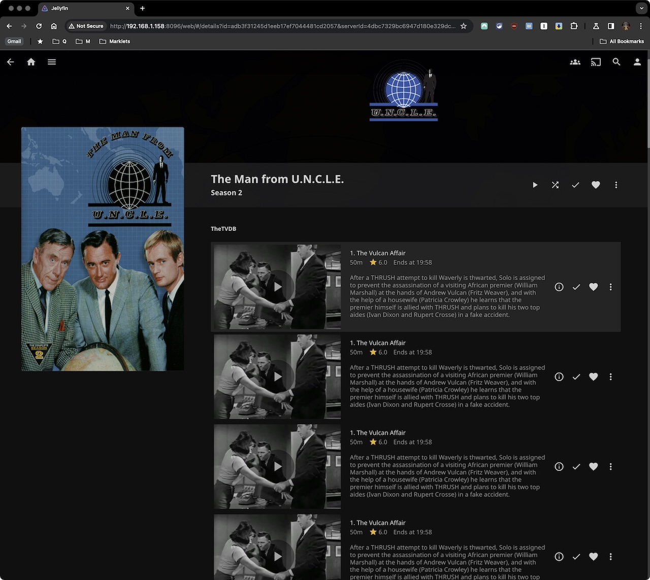

    When I add The Man From Uncle (https://www.thetvdb.com/series/the-man-from-u-n-c-l-e) S01, S02, S03 and S04, the metadata for all S01 episodes is imported correctly. However, the metadata for every episode in every other season is identical to that for S01E01.
    As all of the episodes are all numbered "1", they play out of order.

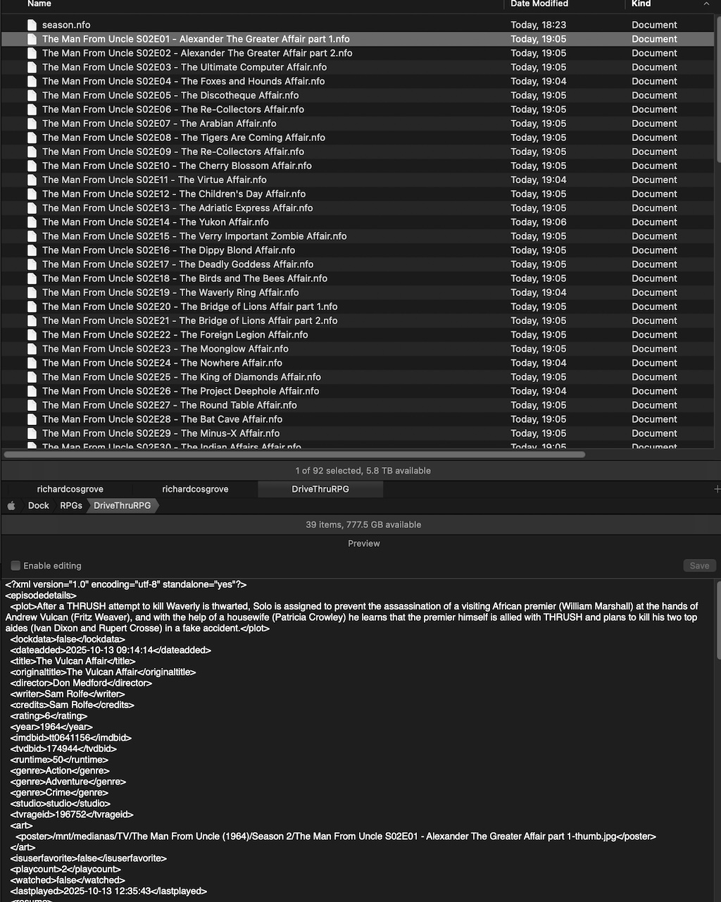

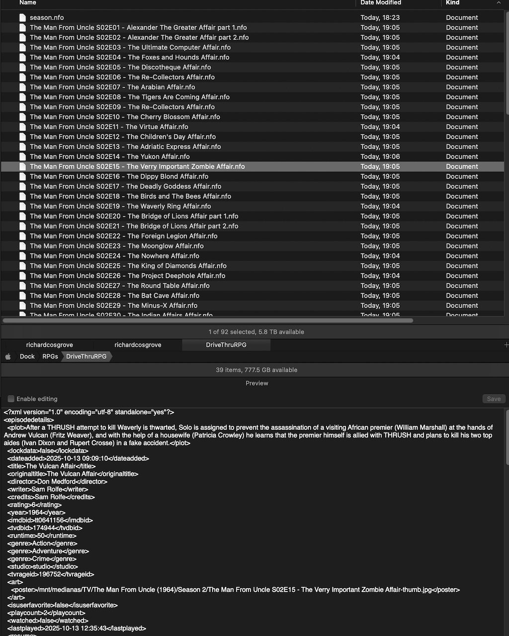

    I have tried removing and re-adding the show, checked TheTVDB and IMDB ID codes are correct (they are). The episodes files are named correctly, and the folder structure is correct.
    The videos play without a problem – it's just the metadata that's screwed up.
    I've not encountered this problem with other TV shows – just this one.
    Any ideas on how to fix this? I don't want to add metadata for 86+ TV shows manually.
    Thanks.
    Jellyfin log:
    I downloaded the Jellyfin log after removing and re-adding the show.
    Jelllyfin log file (download – too big for Pastebin)
    Files and metadata screenshots:
    Jellyfin season pages:
