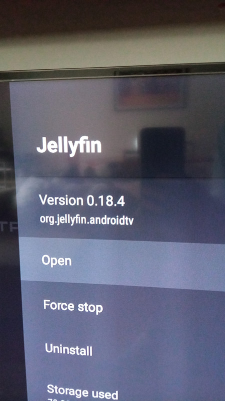

    Android TV app version
    [Image: IMG-20250210-153016-117.jpg]
    Paste Bin
    I posted the audio part, you can see the "Stopped at "0" ms", the audio doesn't start on Android TV.
