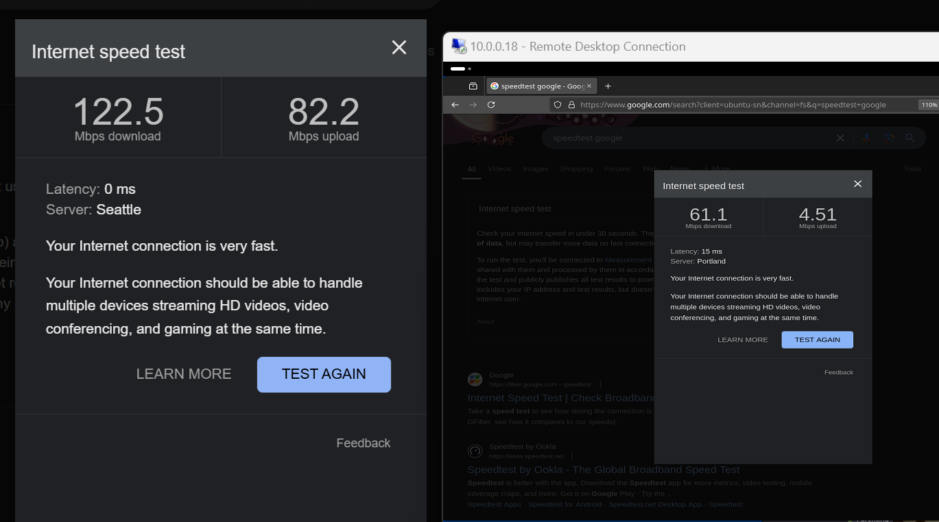

    #15
    2025-01-23, 03:27 PM
    (2025-01-23, 03:17 PM)TheDreadPirate Wrote: I don't think this is caused by any performance issues from the N100.  The only thing that makes sense is that this is a network problem.
    Is this a headless Linux server?  Or does it have a desktop?  Are you able to do any speedtests on it?
    i have full access to it.
    ran a google speedtest
    left is speedtest on win
    right is speedtest on ubu
    Reputation: 460
    #16
    2025-01-23, 03:38 PM
    If 4.51Mbps is also about how fast it is transferring to other PCs on your LAN, that is lower than the bit rate of the all the videos your shared logs for. Which range from ~6-11Mbps, including audio.
    Is the N100 connected to your network over WIFI?
    squirrely123
    Posts: 15
    Joined: 2025 Jan
    #17
    2025-01-23, 03:43 PM
    i think you figured it out. looking at the specs on the my new n100 and my old n100.
    new n100 is using wifi5
    old n100 is using wifi6
    wifi5 is causing that limit
    Reputation: 460
    #18
    2025-01-23, 03:52 PM (This post was last modified: 2025-01-23, 03:52 PM by TheDreadPirate.)
    All my WIFI5 devices get around 300-400Mbps on the 5Ghz band with WIFI6 devices getting around 700-800Mbps.
    WIFI5 on my 2.4Ghz band get around 50-100Mbps.
    So it all depends on what band the Jellyfin server is on, signal strength where it is located, how crowded the spectrum is.
    Move it closer to the router, if possible. Use ethernet if possible. If it is on the 2.4Ghz band, move it to the 5Ghz band.
    Fate
    Posts: 221
    Reputation: 16
    #19
    2025-01-23, 08:04 PM
    Agree, I think you found the issue.
    Another alternative is get a Wlan 6 card with m2 wifi or pcie x1 (whatever you have)
    I would recommend an intel chipset in any case.
    But if you can use an ethernet cable that should be nr1 choice
