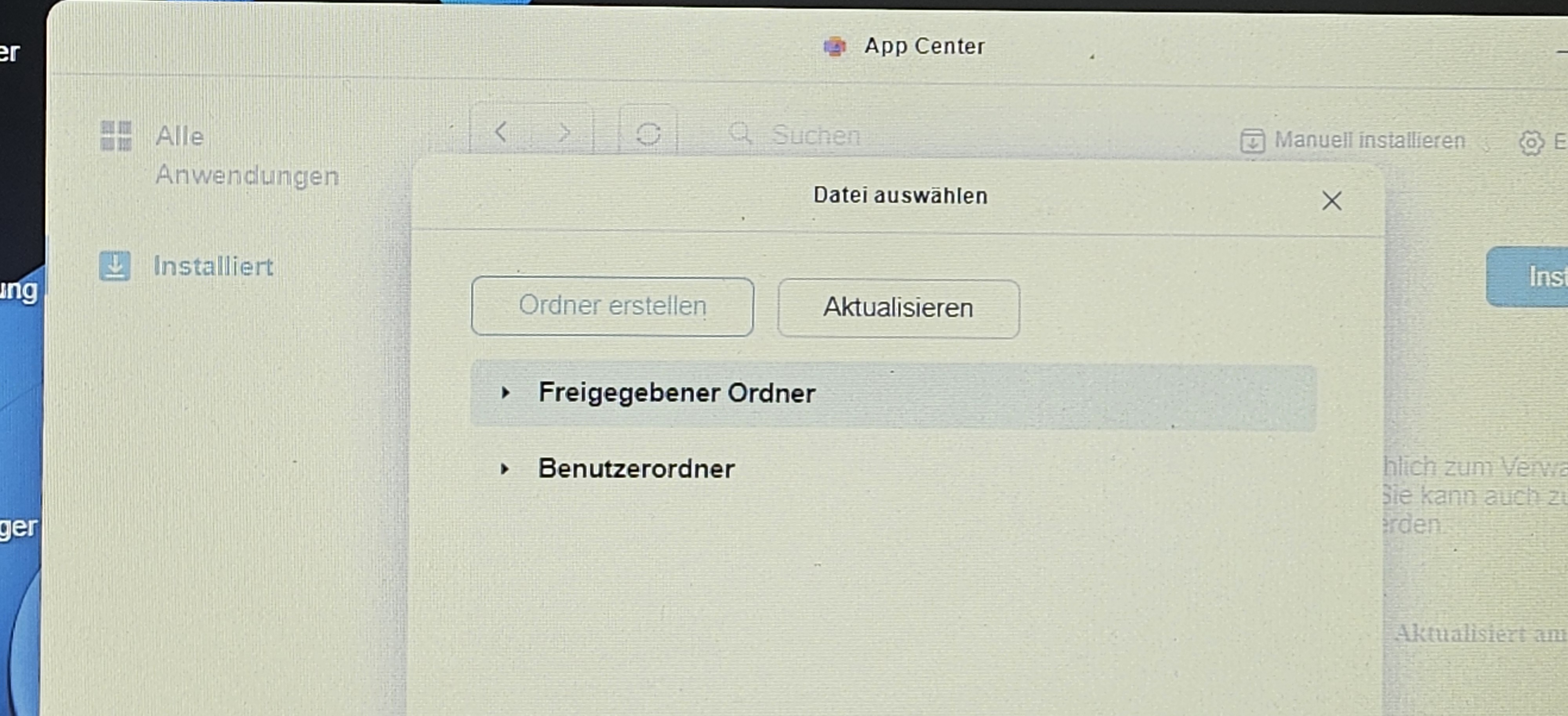

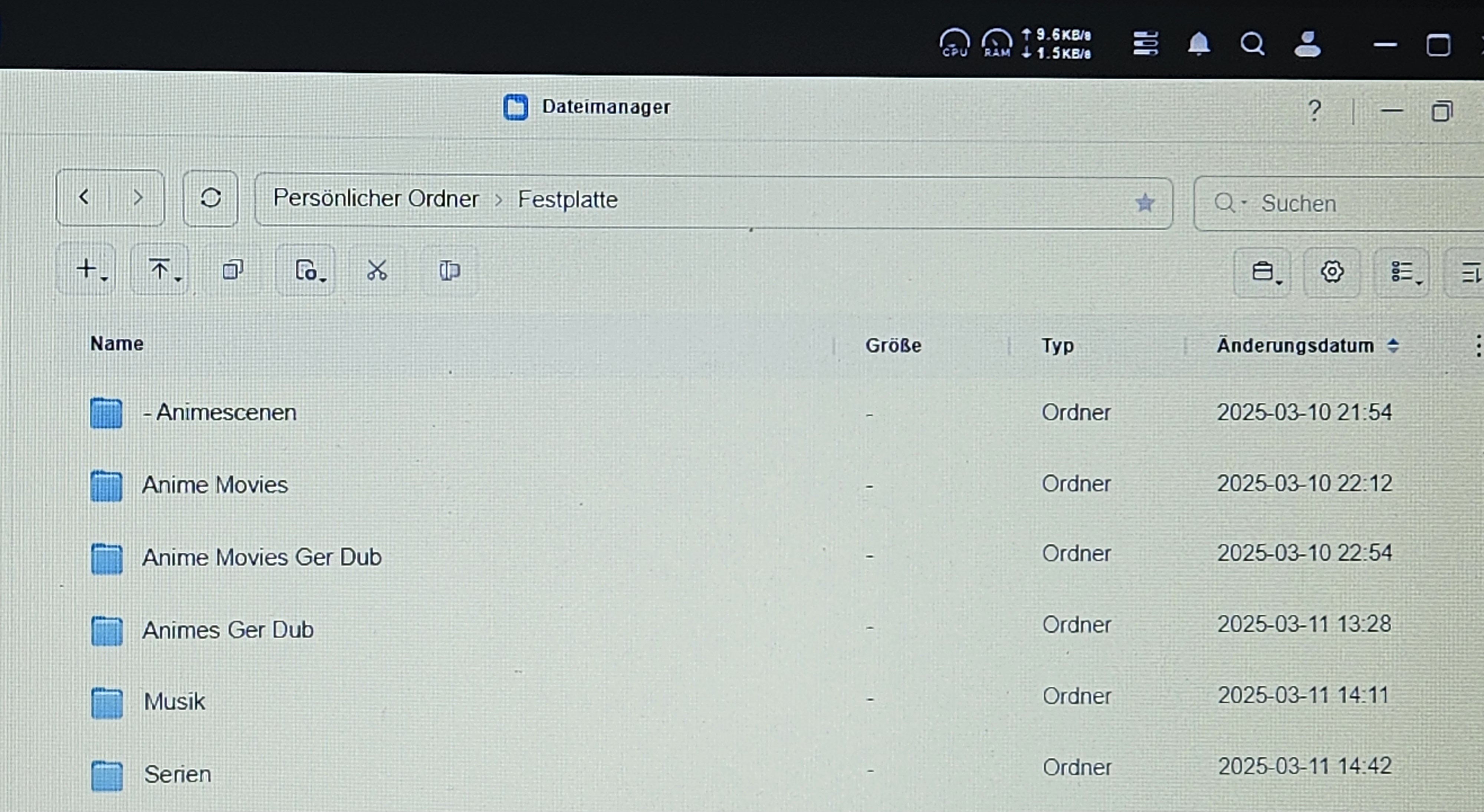

    After restarting my nas I couldn't get acces to my server. I deinstalliert jellyfin and have to created it from the scratch. The Problem is that unless last time I can't give Jellyfin access to my personal folder where all my data are. Last time I could give it access. Because it takes a long time to move all data I hope you can tell my I can give it access again.
    [attachment=7052][attachment=7053]

    What is Jellyfin installed on? Is that Synology DSM in your screenshots?

    It is ugreen nas. Installed with docker.

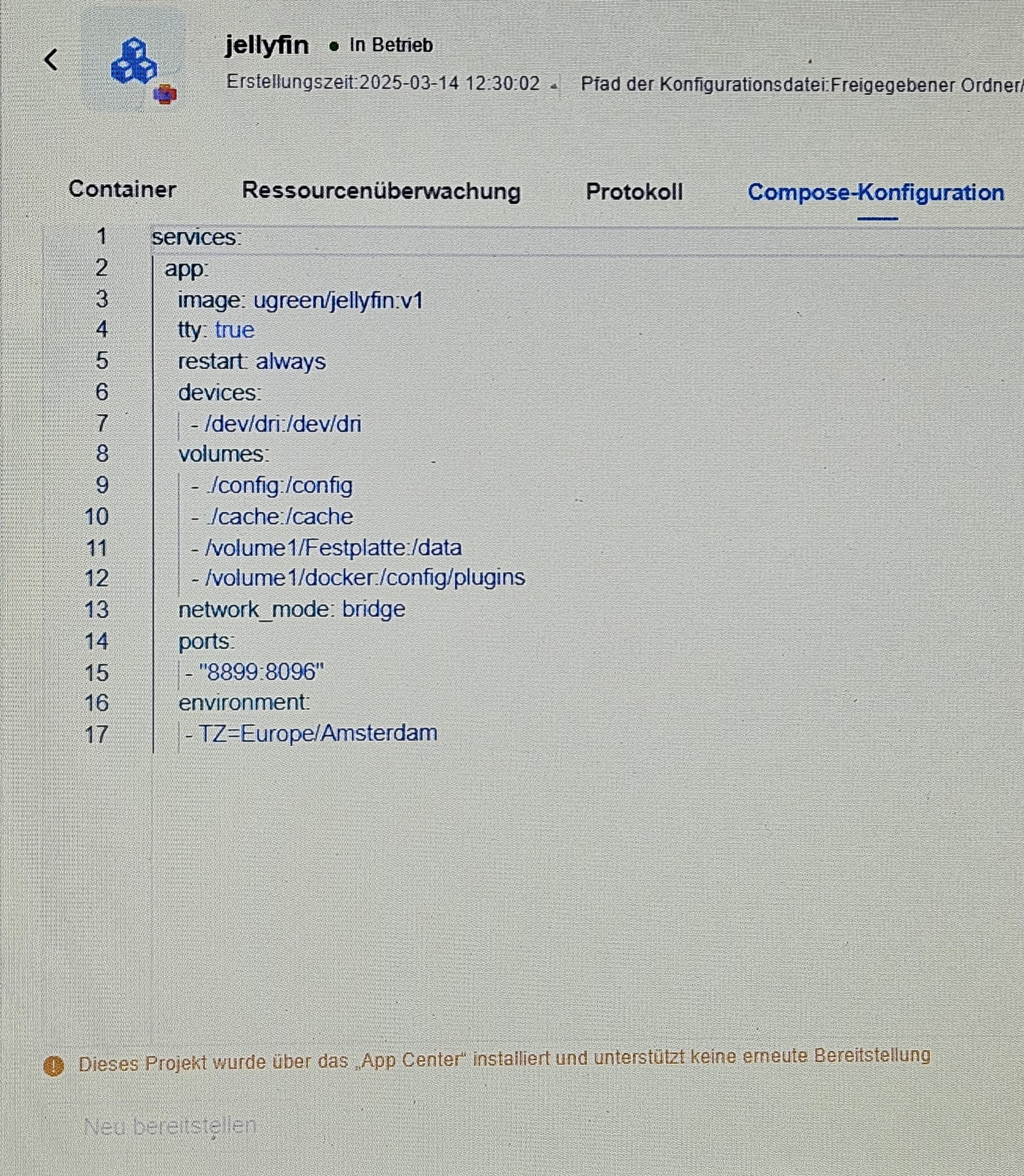

    Can you share the docker compose for Jellyfin? If you use the UI, screenshots of the docker config for Jellyfin.

    2025-03-14, 03:58 PM
    [attachment=7077]

    I'm not sure you are setting /config and /cache correctly for this setup. You should be providing them a directory on /volume1. I'm not sure whether "./config" would work when not using command line docker compose.
