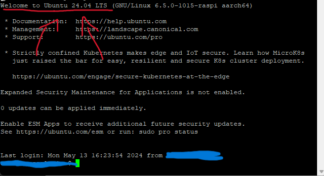

    2024-05-13, 04:49 PM (This post was last modified: 2024-05-13, 04:52 PM by Vosseal. Edited 3 times in total.)
    (2024-05-13, 11:49 AM)TheDreadPirate Wrote: We are only explicitly supporting LTS builds of Ubuntu going forward.  You can lie and change the "suites" field in jellyfin.sources to "noble".  :-)
    Hello TheDreadPirate,
    Thanks for coming back to me so fast, its really appreciated.
    Apologies I should have clarified that I am using Ubuntu 24.04 LTS to host my Jellyfin instance. You can see this within the attached screenshot on this reply.
    When jellyfin was initially configured this server was using 23.10 ( None LTS ) is it the case that my jellyfin.sources file is still setup as if its on 23.10 ubuntu? As I upgraded this server to 24.04 LTS post jellyfin initial installation as you mentioned you wont support non LTS versions. Smiling-face
    Looking forward to hearing back from you.
    Thanks
    Vosseal
    Reputation: 460
    2024-05-13, 04:57 PM (This post was last modified: 2024-05-13, 04:58 PM by TheDreadPirate.)
    I've never seen Ubuntu update apt sources that were added by users. You would have to make the change yourself. jellyfin.sources in your OP is set for mantic and you will have to manually change that to noble.
    Also, 24.04 but with the 6.5 kernel? Shouldn't it be 6.8?
    Welcome to Ubuntu 24.04 LTS (GNU/Linux 6.8.0-31-generic x86_64)
    * Documentation:  https://help.ubuntu.com
    * Management:     https://landscape.canonical.com
    * Support:        https://ubuntu.com/pro
    Last login: Mon May 13 16:37:49 2024 from 192.168.1.2

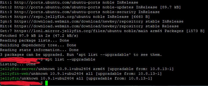

    Hello all, It would appear that what I assumed in my last post was definitely the case.
    Because I was running Ubuntu 23.10 ( NON-LTS ) when I initially installed my Jellyfin server the jellyfin.sources file was created with 'Mantic' as the 'Suites' field instead of 'Noble' as that was the current version of OS which was running.
    So when I performed an In-Place upgrade from 23.10 ( NON-LTS ) to 24.04 ( LTS ), the In-Place upgrade didn't go and change the jellyfin.sources file automatically from 'Mantic' to 'Noble'. Amending this field within /etc/apt/sources.list.d/jellyfin.sources from 'Mantic' to 'Noble' did the trick as shown in the attached screenshot.
    Hopefully this helps others within similar issues. Thanks again for the communication within this forum.
