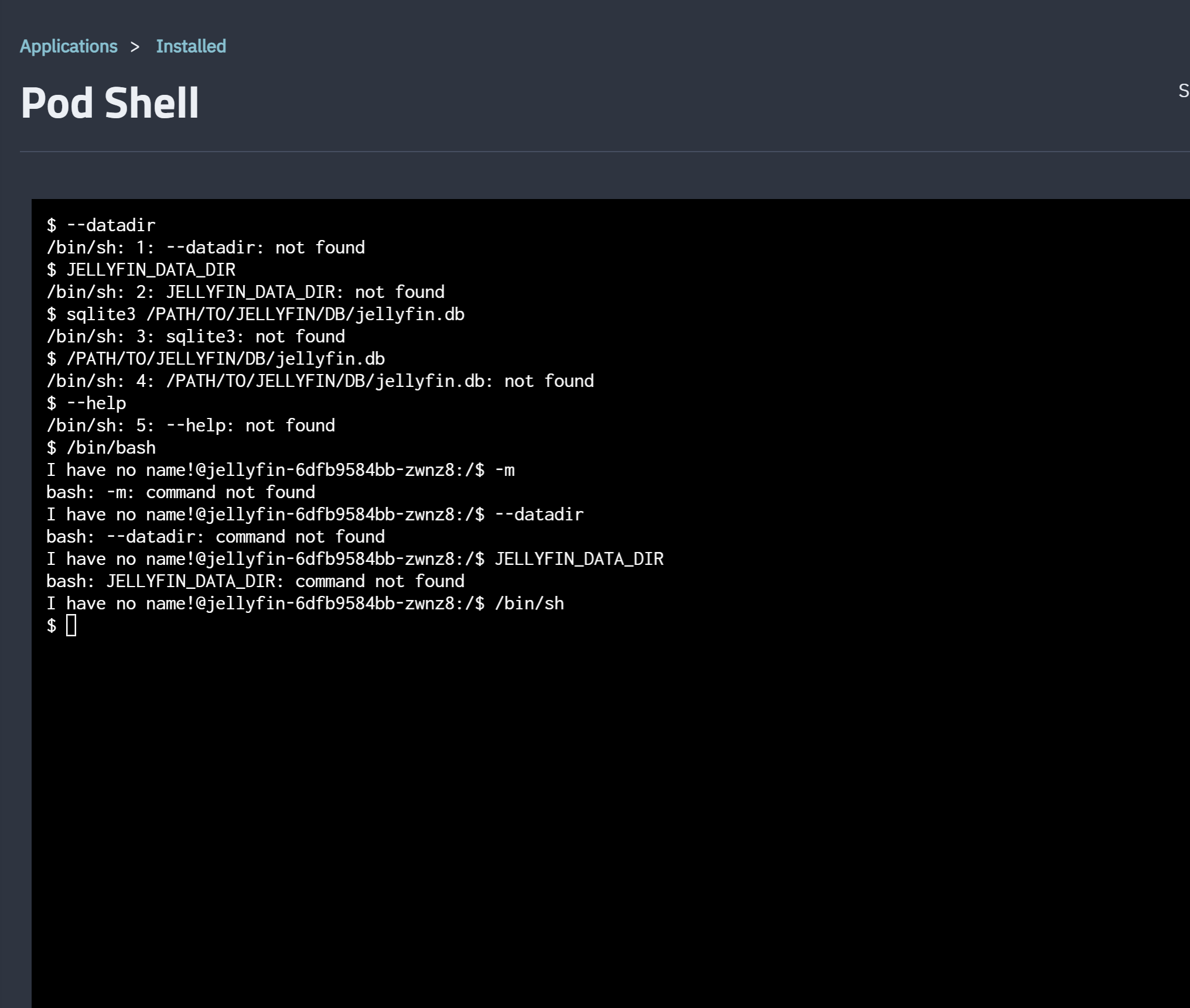

    i got into the shell of jellyfin, but i'm having issues with the commands, i tried the ones you gave me i know they should work. I can admit it's all user error.

    In that shell, try using the following commands:
    • ls -l {To print items in current directory. -l flag to display it in a list with info}
    • cd <directory to move into> {cd "change directory" will allow you to move around directories}
    • cat <filename> {prints out a file to the screen}

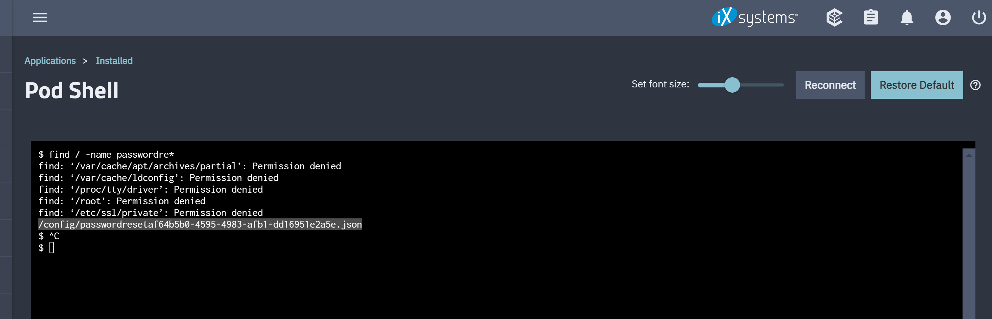

    thanks loads im gonna try that but look at this, i think it's saying i don't have permission. But please confirm for me please, thanks

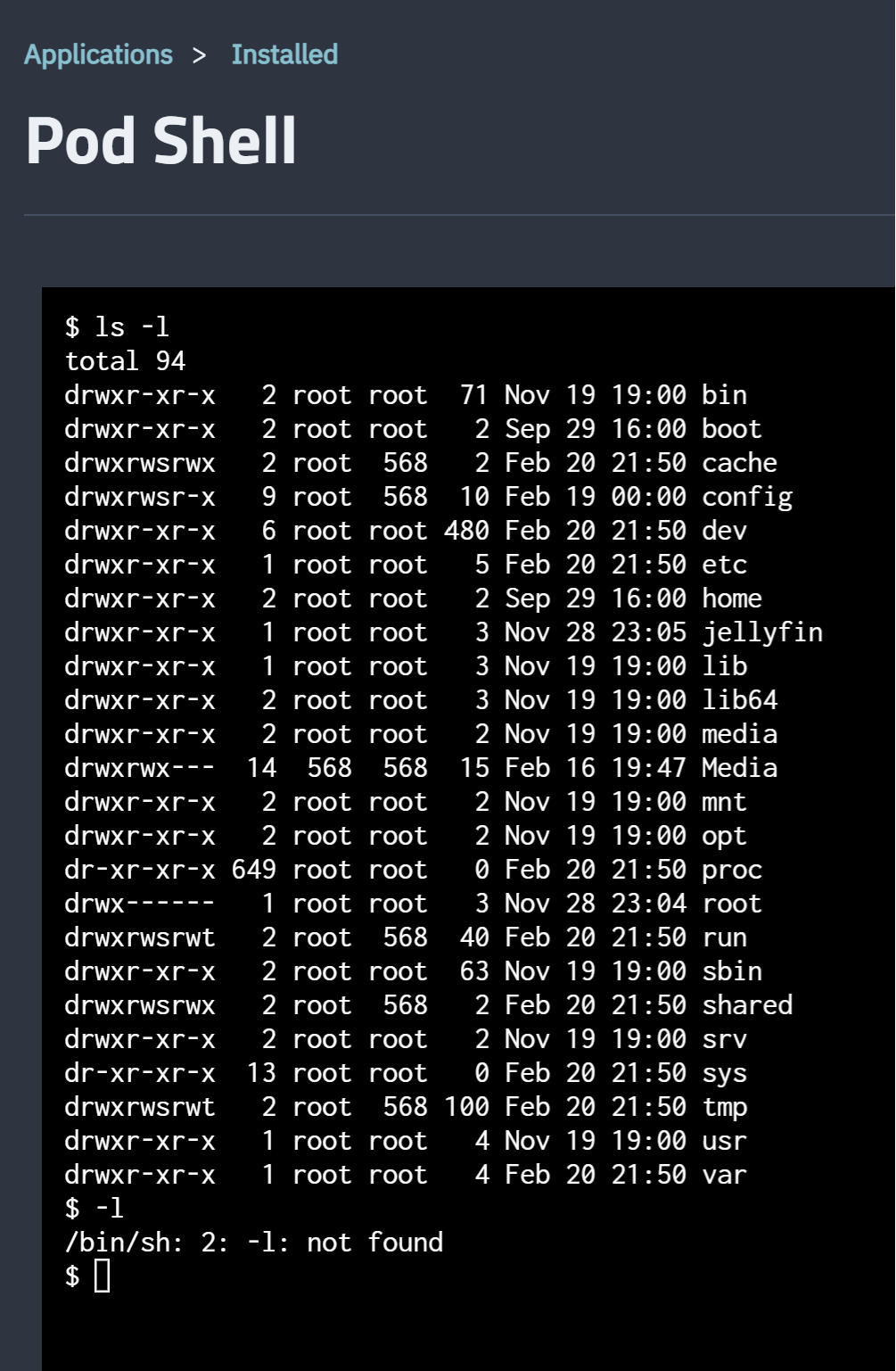

    this is where i am, whit CAT, do i use the jellyfin name or the set of letters and numbers infront?
