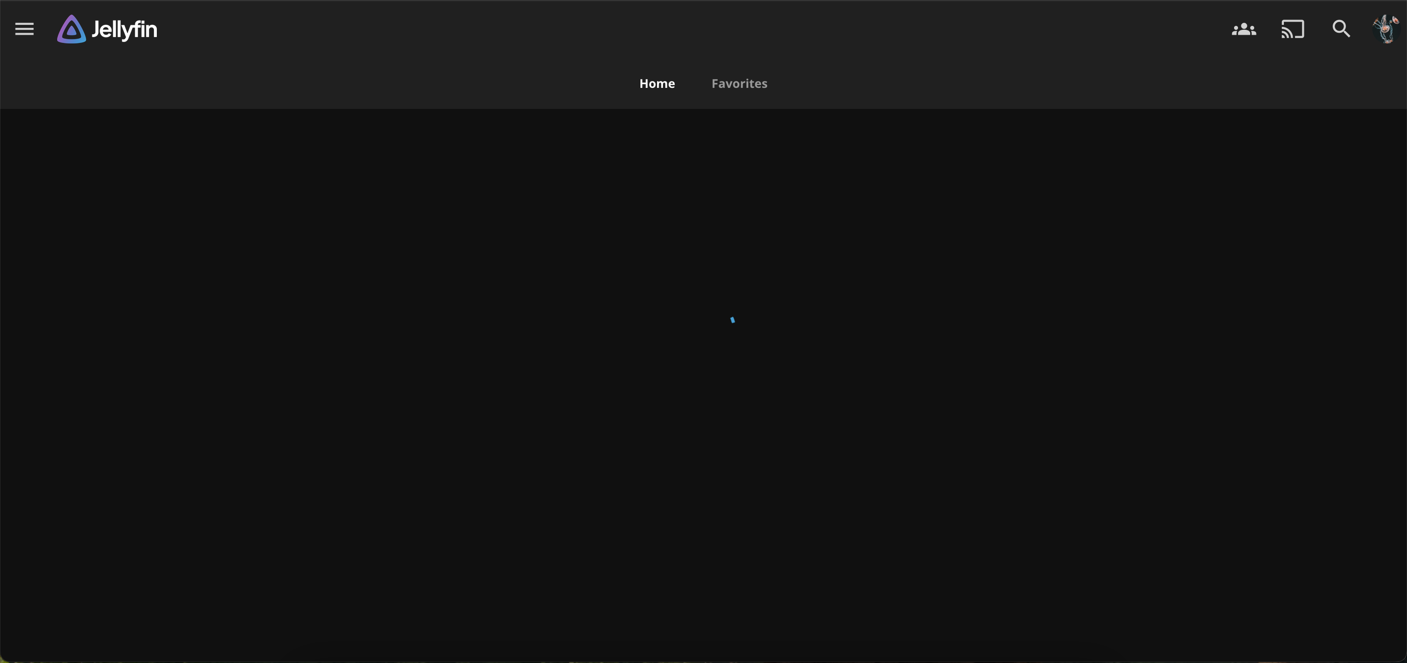

    My Jellyfin (v 10.10.6 run through Docker on Ubuntu server) stopped loading all media today. I am stuck on a screen with a perpetual loading icon. I can go into the dashboard manager and make changes but cannot get any media to load for any user.
    I've tried stopping, removing, and re-installing, but to no success. Originally, my mounted drive seemed to have changed names (Internal to Internal1). It has since been re-mounted at the correct location.
    Here is a link to my log file, which was too large to upload to the forum: https://filebin.net/y3oy719r09zl4fbh
    Any help would be appreciated.
