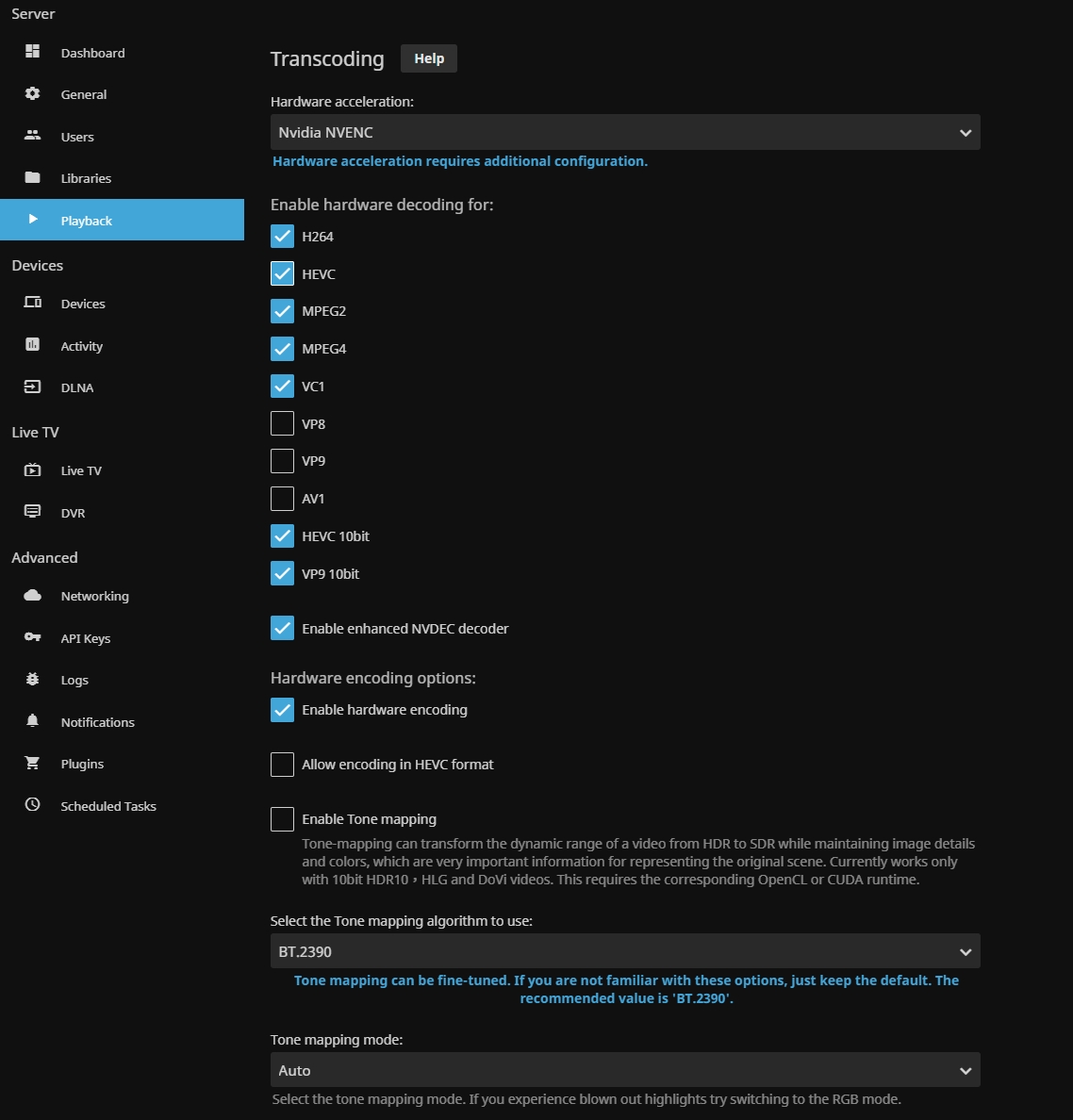

    Can you also share a screenshot of your Transcode settings? Settings > Dashboard > Playback.

    I am running Synology DSM on a custom unit with a Nvidia T400. Here are the screenshots of my Transcode settings....
