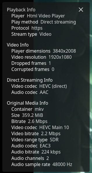

    playback setting displayed in ui before playback stop:
