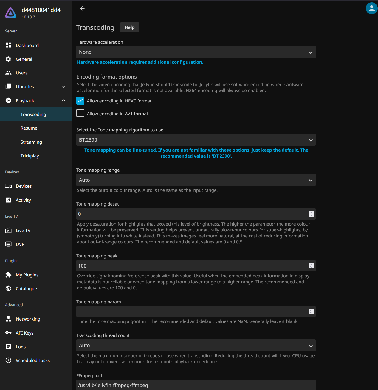

    hello, i am trying to setup jellyfin for the first time and i am getting an error on playback attempts :
    "PlaybackError.mediadecodeerror"
    any help would be greatly appreciated, i will include logs, however i only included the last 33 lines because it was too long otherwise
    i am currently not using a dedicated gpu for encoding/decoding so this may be part of the problem

    i have some more informantion, it seems to be a permissions problem judging by some of the transcode attempt logs:
    {"Protocol":0,"Id":"d5e65019cf2ce972cb8618bcb7a97550","Path":"/mnt/Swimming2/Princess Bride Ce.mkv","EncoderPath":null,"EncoderProtocol":null,"Type":0,"Container":"mkv","Size":null,"Name":"Princess Bride Ce","IsRemote":false,"ETag":"b3dd1cf0b71a50d1f2c444f4b6e886ed","RunTimeTicks":null,"ReadAtNativeFramerate":false,"IgnoreDts":false,"IgnoreIndex":false,"GenPtsInput":false,"SupportsTranscoding":true,"SupportsDirectStream":true,"SupportsDirectPlay":true,"IsInfiniteStream":false,"UseMostCompatibleTranscodingProfile":false,"RequiresOpening":false,"OpenToken":null,"RequiresClosing":false,"LiveStreamId":null,"BufferMs":null,"RequiresLooping":false,"SupportsProbing":true,"VideoType":0,"IsoType":null,"Video3DFormat":null,"MediaStreams":[],"MediaAttachments":[],"Formats":[],"Bitrate":null,"FallbackMaxStreamingBitrate":null,"Timestamp":null,"RequiredHttpHeaders":{},"TranscodingUrl":null,"TranscodingSubProtocol":0,"TranscodingContainer":null,"AnalyzeDurationMs":null,"DefaultAudioStreamIndex":null,"DefaultSubtitleStreamIndex":null,"HasSegments":false}
    /usr/lib/jellyfin-ffmpeg/ffmpeg -analyzeduration 200M -probesize 1G  -i file:"/mnt/Swimming2/Princess Bride Ce.mkv" -map_metadata -1 -map_chapters -1 -threads 0 -sn  -copyts -avoid_negative_ts disabled -max_muxing_queue_size 2048 -f hls -max_delay 5000000 -hls_time 3 -hls_segment_type fmp4 -hls_fmp4_init_filename "81d7d7df8a03533a845e759d23f28985-1.mp4" -start_number 0 -hls_base_url "hls/81d7d7df8a03533a845e759d23f28985/" -hls_segment_filename "/cache/transcodes/81d7d7df8a03533a845e759d23f28985%d.mp4" -hls_playlist_type event -hls_list_size 0 -y "/cache/transcodes/81d7d7df8a03533a845e759d23f28985.m3u8"
    ffmpeg version 7.0.2-Jellyfin Copyright © 2000-2024 the FFmpeg developers
    [in#0 @ 0x5607b28d1540] Error opening input: Permission denied
    Error opening input file fileConfused-facemnt/Swimming2/Princess Bride Ce.mkv.
    Error opening input files: Permission denied

    i am currently runing jellyfin inside the apps container in truenas scale, i am extremly new to truenas and jellyfin and currently just want to get it working.
    it is also entirely possible that the system that jellyfin is running on is way too slow for encoding. it doesnt have a dedicated encode/decode gpu and us running on a 4th gen i3. Im not sure that i would be able to make any changes outside of the truenas interface without breaking something.
    thank you for the help!
