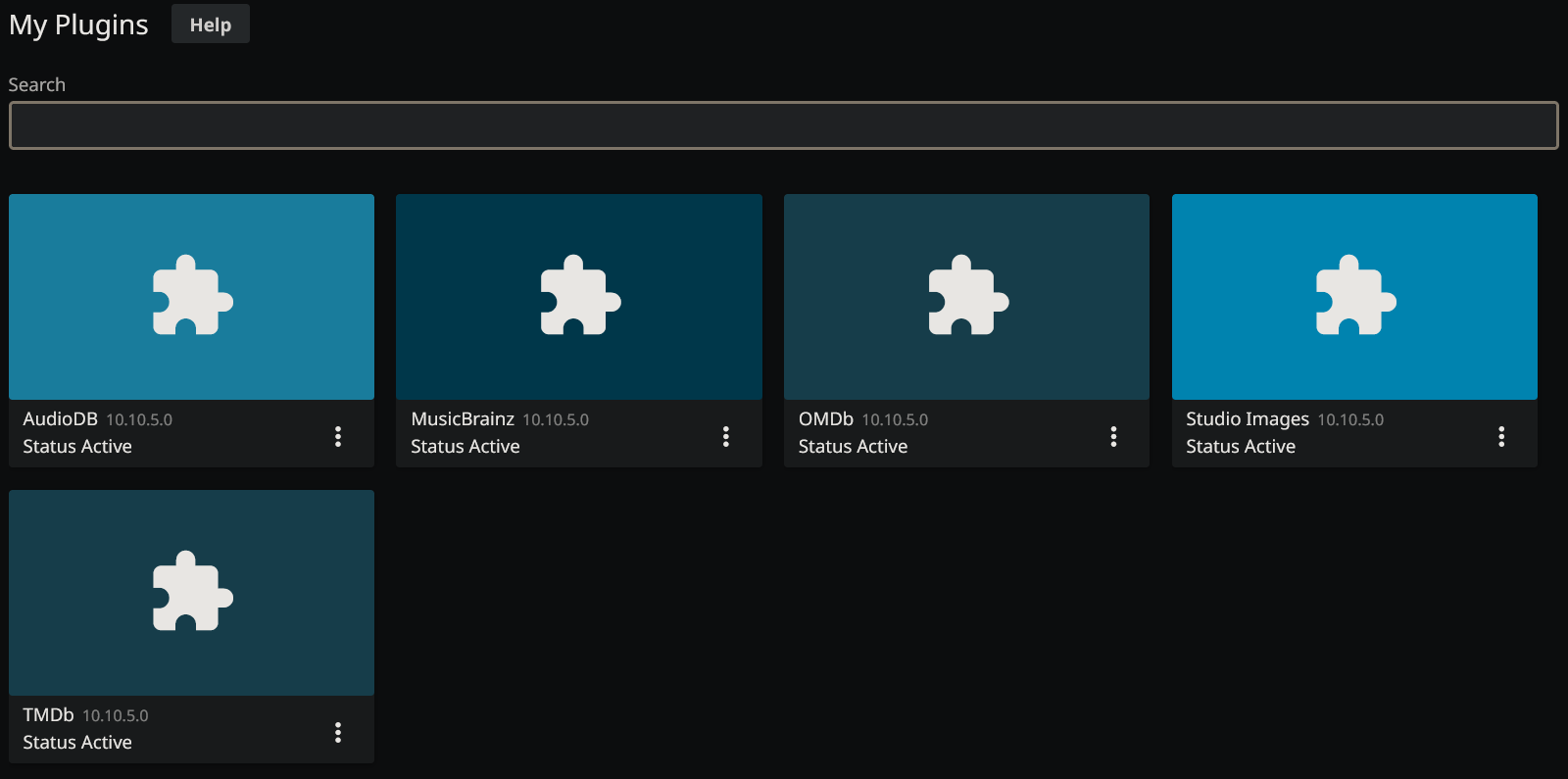

    I've got Jellyfin set up on my Synology NAS using the jellyfin/jellyfin Image from Docker Hub installed through Container Manager, and *almost* everything is working exactly as it should. Everything except for plugins.
    In the administration dashboard I can see my installed plugins all showing as active

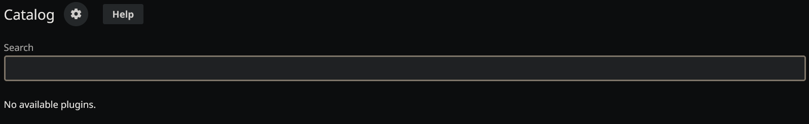

    but no metadata is loading for any of my files, and I cannot add any plugins through the catalogue.

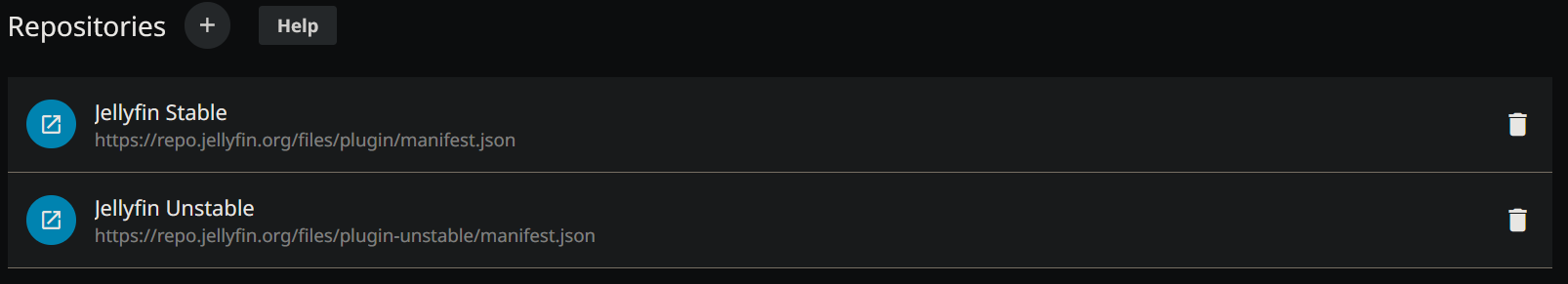

    My plugin catalogue shows nothing
    despite the correct repos being loaded (I tried adding the unofficial just to see if it would change anything but it didn't)
