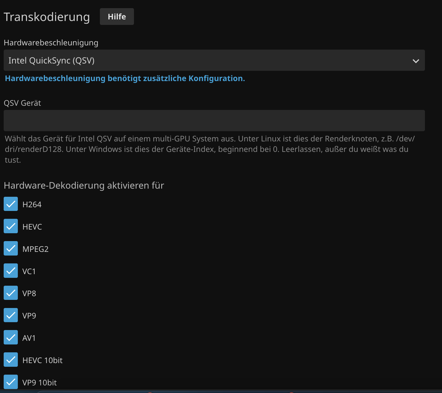

    Can you provide an ffmpeg log for the item transcoding? Looks like it's not using hardware acceleration (see lines 337+). Maybe a screenshot of your hardware acceleration options in Jellyfin web? Would be helpful to know how you're running Jellyfin (e.g., bare metal, OS, virtualization).

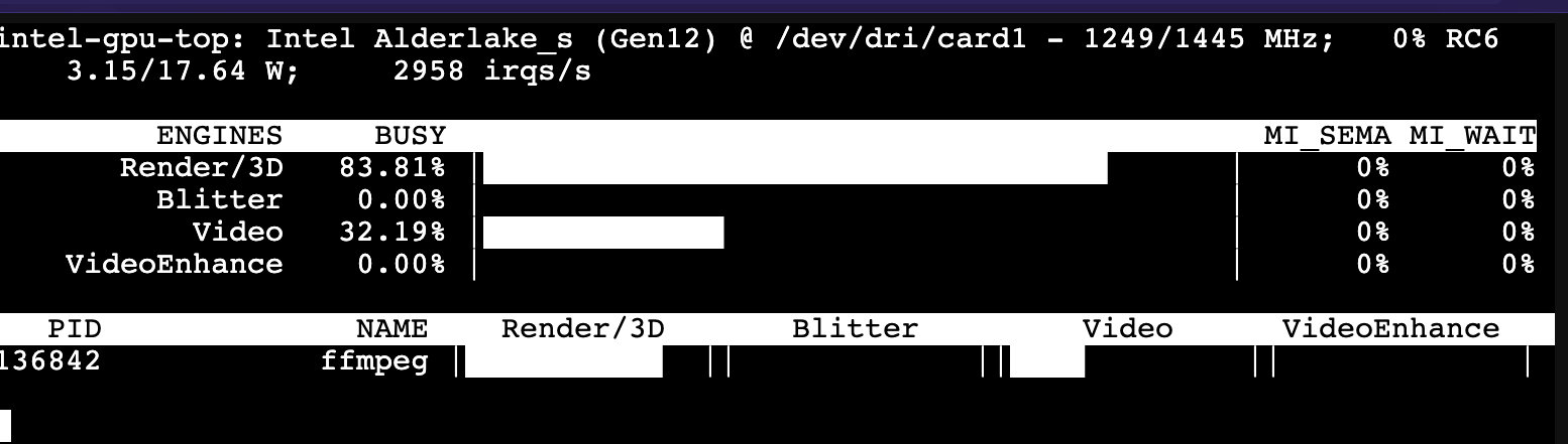

    Here is also a screenshot of HW Acceleration, its set to quicksync. I dont see any transcoding happening so far. When I am using my clients in my wifi everything seems fine.
    The server is running as a lxc container in proxmox. But it should be setup correct to use hw acceleration as far as i can see. I also did a test to force trancsoding which was using the igpu on the host then. Attached a screenshot of this also.

    There isn't any HWA since it is only transcoding the audio.

    AFAICT, nothing is wrong on the server.  It is transcoding plenty fast.
