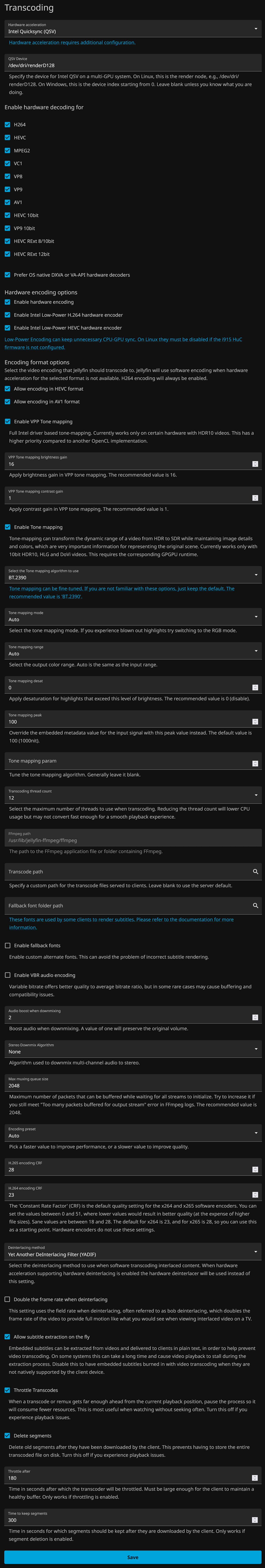

    Most of my transcode settings are the default settings, or adjusted based on recommendations from browsing the forum etc. I'm posting a screenshot so that you can compare and adjust as necessary.
