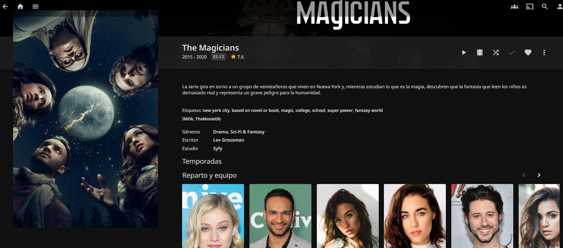

    I have managed to get all the series to appear, every time I identified one, the next one appeared, but now all the ones I have identified appear without seasons or episodes, I have checked that everything is well named, for example The Magicians/Season 01/The Magicians s01e01.

    Permission issues could possibly explain your issues identifying shows.
