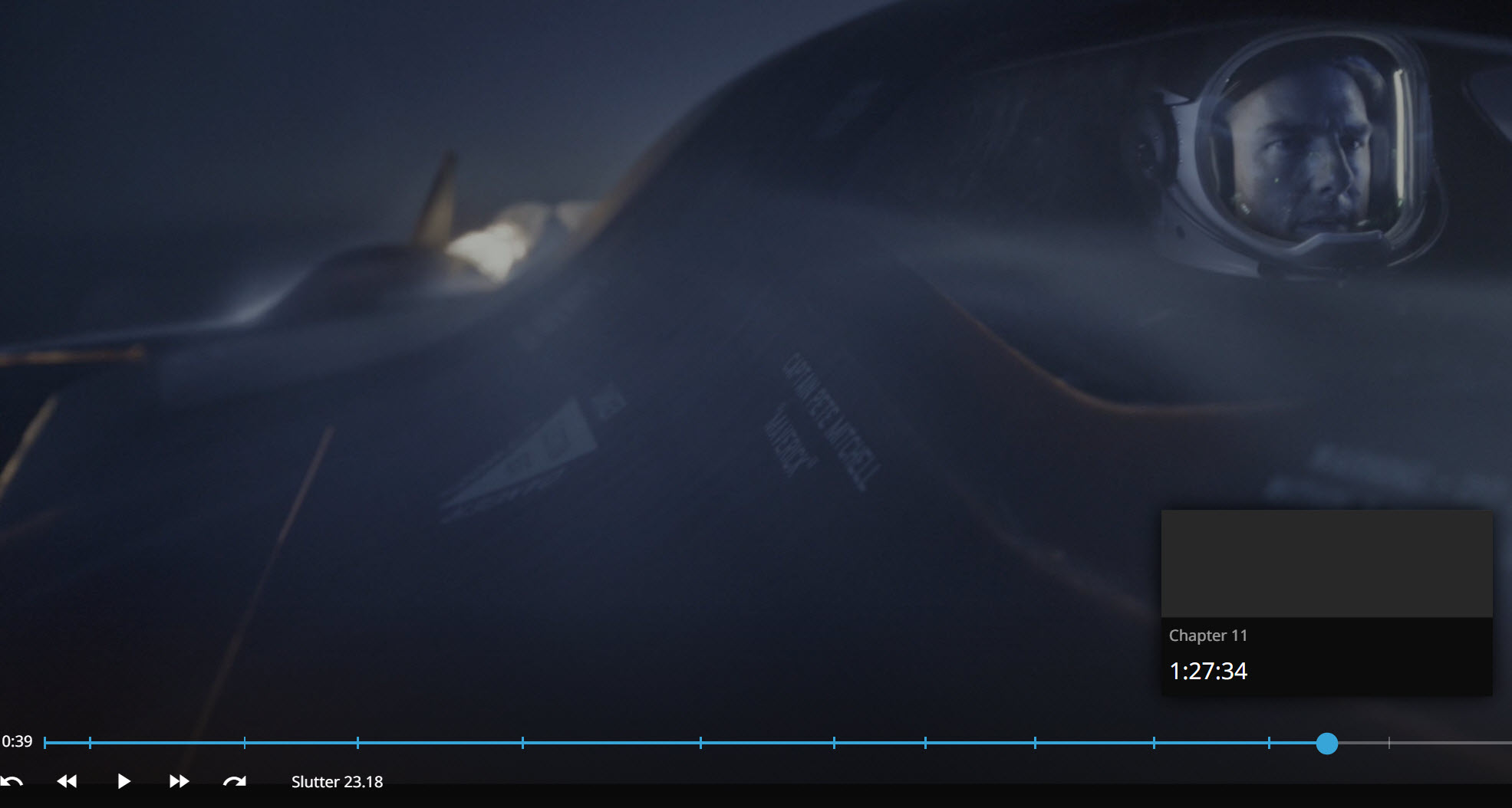

    I have a load of existing bif files created from before all in the mediafolder and correct named, but for some reason it only works sometime?
    They are all created by Emby and they are working in Emby. But I am trying to make a shift to Jellyfin.
    So far I have tested read/write access and I can see that Jellyfin tries to read the file, but I get a dark square over the timeline with no picture?

    Bif is no longer a thing. That functionality was integrated into Jellyfin as Trickplays.
    You should be able to convert them, see here for details: https://github.com/nicknsy/jellyscrub
    "Trickplay functionality has been upstreamed into Jellyfin 10.9.0, and as such, Jellyscrub's trickplay functionality will not be maintained after 10.9.0 is officially released. However, Jellyscrub has been updated to version 2.0.0 which only allows for the conversion of your already generated .bif files to Jellyfin's new native format."
