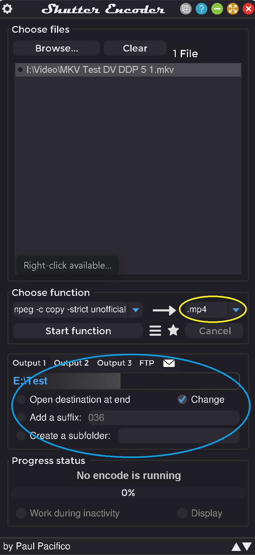

    Open Shutter Encoder, and add the file/files to be converted.
    In the "Choose function" dropdown box (highlighted red in figure 1 and 2), do not choose an option. Instead, enter the following text...
    ffmpeg -c copy -strict unofficial
    If you have subs in the MKV you wish to include (like forced subs), then enter the following text instead...
    ffmpeg -c copy -c:s mov_text -strict unofficial
    In the dropdown box beside it (highlighted yellow in figure 2 and 3), there will be various options like mp3, but mp4 will not be there. Just type ".mp4"
    If you wish to save the new file somewhere else (change), add a suffix to the filename or add a subfolder, see the Output options (highlighted in blue in figure 3).
    Once you are ready, click "Start function" (highlighted green in figure 4).
    The speed will depend on various factors, such as how many files you are batch processing, whether you are using the same drive for the new files or a different drive, along with the speed of the drive/drives.
    Once done, it is just a matter of ensuring the files are named correctly for Jellyfin as per the FAQ for Movies and TV Shows.
    Then you just need to remove the MKV versions from your Jellyfin server, and upload the new MP4 versions.
