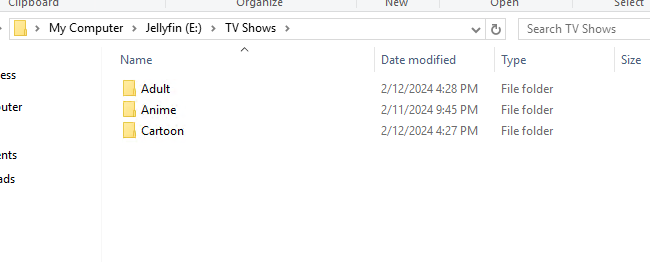

    CoolJZero
    2024-02-13, 12:06 AM
    [Image: RXjH7jb]
    Attached is how my T.V Shows folder is setup and assistance would be appreciated, I feel like since it was simple jellyfin wouldn't have any issues with it, but guess i was wrong
    duckrental
    Posts: 30
    2024-02-13, 12:11 AM (This post was last modified: 2024-02-13, 12:11 AM by duckrental. Edited 1 time in total.)
    You can't have another "layer" between the folder the library is watching and the individual series folders. If you really want everything in one library but you want to keep the folders set up like this, you'll need to add the "Adult", "Anime", and "Cartoon" folders to your library separately, rather than just adding the "TV Shows" folder.
