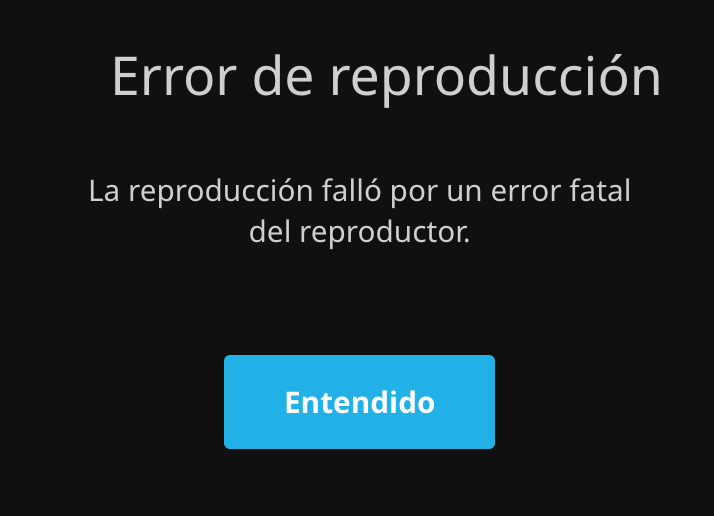

I'm quite new to Jellyfin, and after restarting my Mac (and therefore the Jellyfin server), I've started encountering a playback error. Some of my viewers (namely, my girlfriend) reported that certain episodes no longer play. Jellyfin tries to start the stream but then throws an error.
The error shown is the typical playback error message (in Spanish, since I'm based in Spain).
