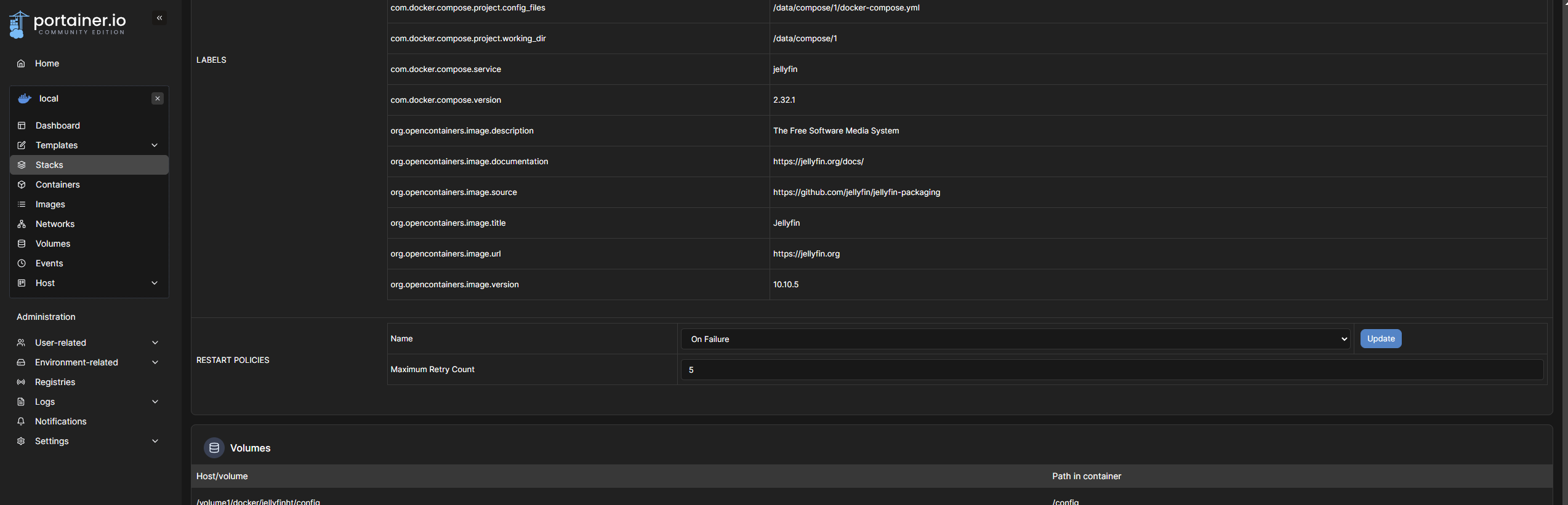

    If the desktop is direct playing, the GPU does not come into play. If the phone needs video transcoding, but you didn't setup the container correctly, that would explain why it fails.
    You'd need to provide either a YML file for the docker container or screenshots of portainer. It looks like the GPU is not accessible to the container based on the ffmpeg log you provided.

    Alright, sorry for the inexperience on my part. I'm not sure where to get a YML file, but ill look and see if I can get it and send what ive got for now. I'm not sure what you need from portainer either so Ill add some images. All I DO know is that its off. The guide says it included enabling it, auto updates, and auto restarts, but docker lists it all as disabled. I guess I configured it wrong in that case but not sure how to fix it. Sorry for all the images, but I'm gonna dump the stuff I can see from portainer and docker. lmk If there's more you need or what I should/need to do.
