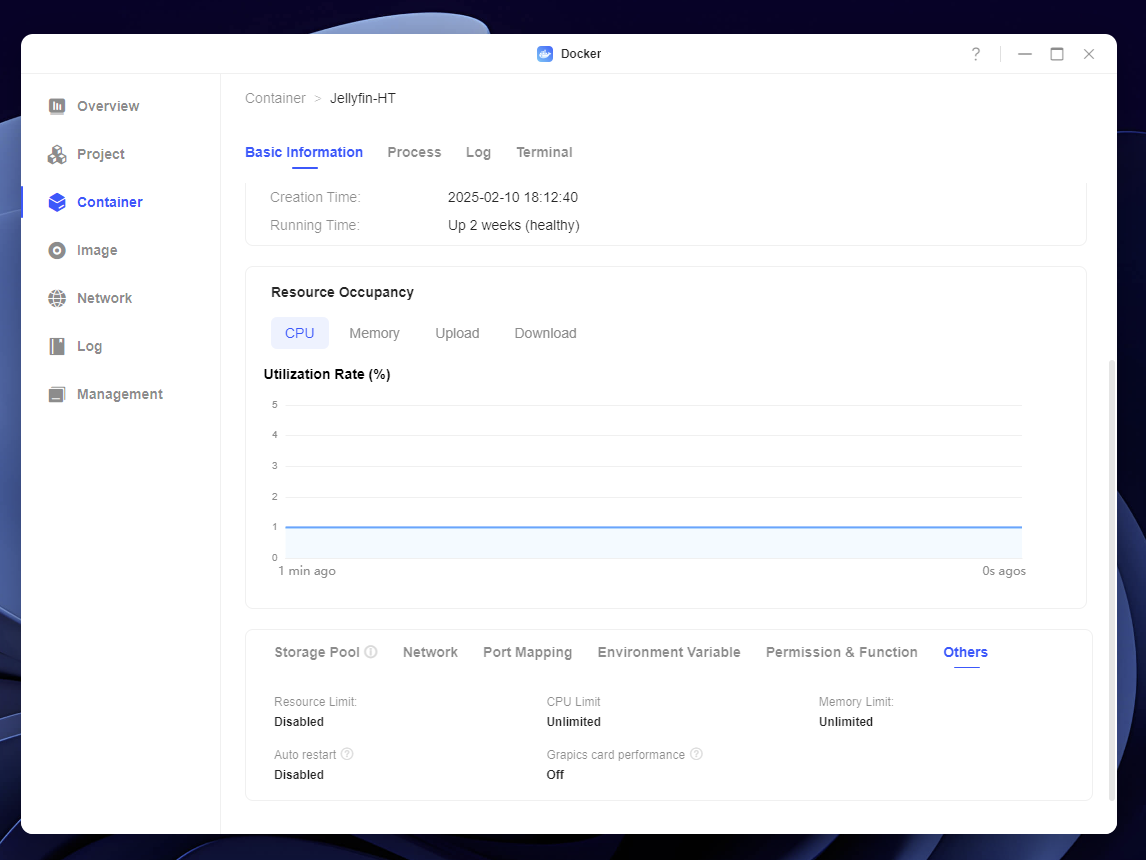

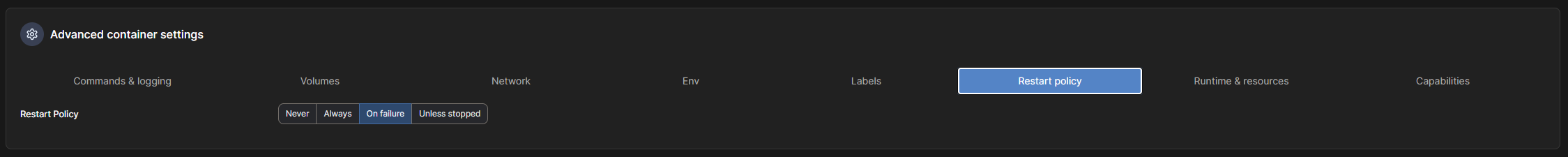

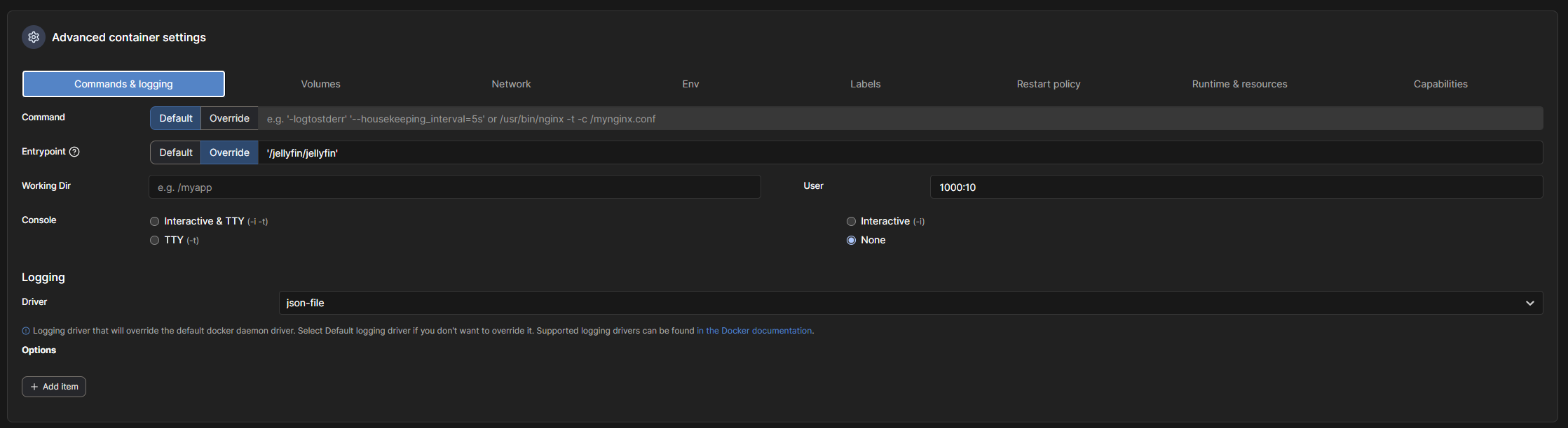

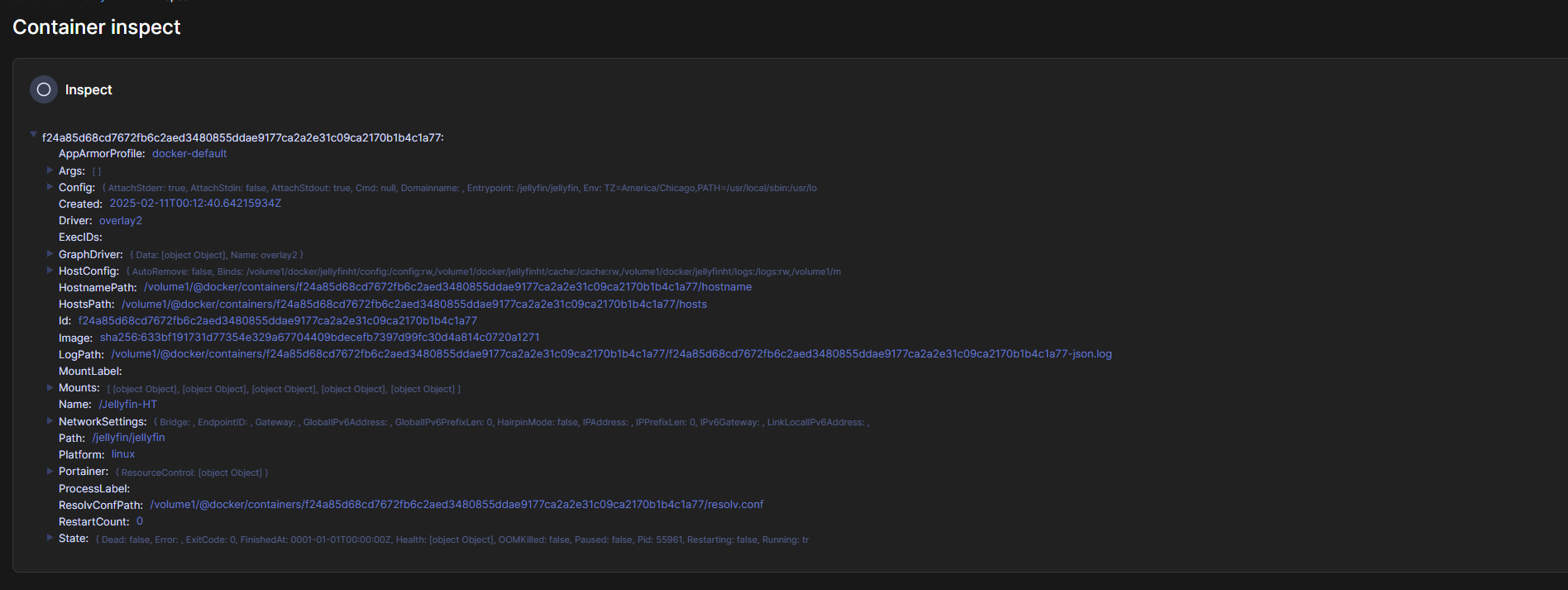

    Alright, sorry for the inexperience on my part. I'm not sure where to get a YML file, but ill look and see if I can get it and send what ive got for now. I'm not sure what you need from portainer either so Ill add some images. All I DO know is that its off. The guide says it included enabling it, auto updates, and auto restarts, but docker lists it all as disabled. I guess I configured it wrong in that case but not sure how to fix it. Sorry for all the images, but I'm gonna dump the stuff I can see from portainer and docker. lmk If there's more you need or what I should/need to do.

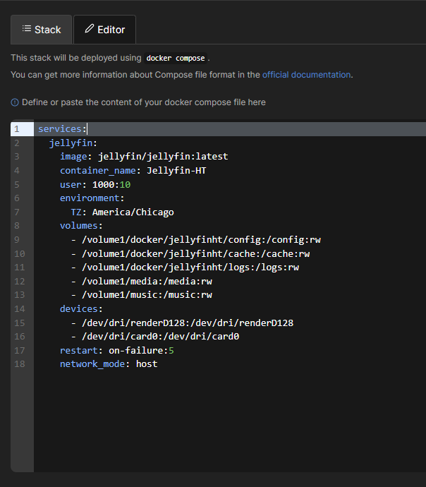

    Heres what I was given to use to create the Jellyfin stack as well.
