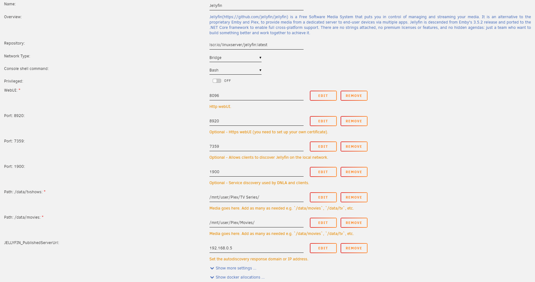

    Below is a screenshot of the setup.
    Port 8096 is shown as a default port and I haven't changed that.
    Jellyfin defaults its url as 192.168.0.5 which Ive tried and also tried replacing it with my server ip, but neither seems to work.

    2023-09-18, 12:19 AM (This post was last modified: 2023-09-18, 12:20 AM by bitmap. Edited 1 time in total.)
    The published IP should be the IP of your Unraid box. You don't have to change the ports, but that can change how you access. I would change the IP to your Unraid IP and restart the container.
    For the error you're seeing, guessing it's this: https://docs.linuxserver.io/faq#jammy
    So you would probably need to add the additional line suggested in option 2, which you can do with one of the bottom two options (I think in show more settings).

    2023-09-18, 06:16 AM
    Thankyou!
    All is working now from what I can see.
