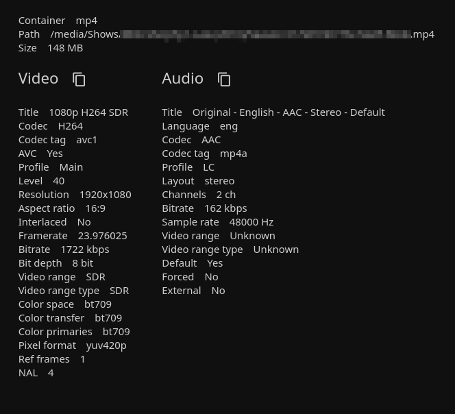

    (2024-08-28, 12:54 AM)TheDreadPirate Wrote: And can you provide the media info for some of your problem videos?
    Attached a screenshot. My original post also had the output of ffprobe if you want that information.
    Container: mp4
    Path: /media/....mp4
    Video
    Title: 1080p H264 SDR
    Codec: H264
    Codec tag: avc1
    AVC: Yes
    Profile: Main
    Level: 40
    Resolution: 1920x1080
    Aspect ratio: 16:9
    Interlaced: No
    Framerate: 23.976025
    Bitrate: 1722 kbps
    Bit depth: 8 bit
    Video range: SDR
    Video range type: SDR
    Color space: bt709
    Color transfer: bt709
    Color primaries: bt709
    Pixel format: yuv420p
    Ref frames: 1
    NAL: 4
    Audio
    Title: Original - English - AAC - Stereo - Default
    Language: eng
    Codec: AAC
    Codec tag: mp4a
    Profile: LC
    Layout: stereo
    Channels: 2 ch
    Bitrate: 162 kbps
    Sample rate: 48000 Hz
    Video range: Unknown
    Video range type: Unknown
    Default: Yes
    Forced: No
    External: No
    Also, I just upgraded my Linux kernel version, so I'll see if that helps later today.
