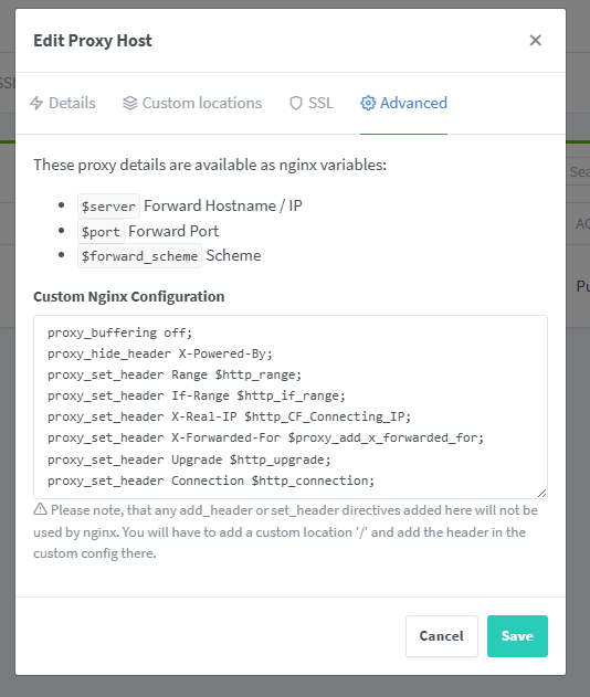

    I'm using Jellyfin with Ningx Proxy Manager, and I've been getting some playback stutters, and I didn't know what it was. But it turns out the video playback isn't caching ahead fast enough for the playback to catch up, so it buffers because it's not loading in, so I lower the quality of the playback, and it seems to be better because the video loads faster. Right now, my server is getting around 1 gigabit speed to my server, and I'm using Cloudflare DNS with Nginx Proxy Manager. I tried adding some tweaks to the Nginx proxy host, but nothing. Is there a way to "improve" the speed of the Nginx Proxy, or is it just limited to the network speed that I have?
